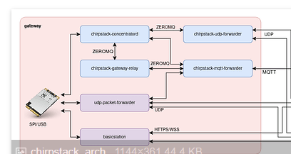

in this hub repository https://hub.docker.com/r/xoseperez/chirpstack-concentratord i couldnt find docker-compose.yml example as mentioned
i want to create something like this with dcoker compose
You can check these here: GitHub - xoseperez/chirpstack-docker: Setup ChirpStack using Docker Compose
Thank you Xose Pérez, but i want to setup Mesh and concentratord can i do with that setup?
Check the start.sh script. The mesh component is there and in the script you get a simple comment on what components to enable on relay and border gateways.
