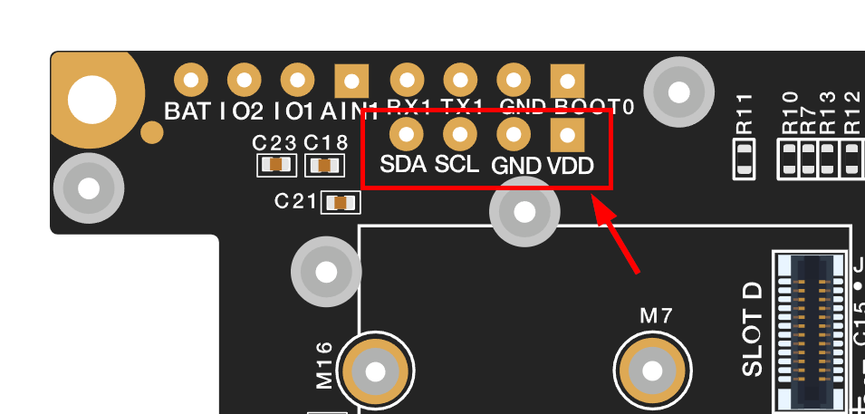

Ah, I got the I/O version, and not the I2C. That’s probably my problem! What would be the right pin holes to put the I2C version in?
The I2C header has label at the back of the baseboard.

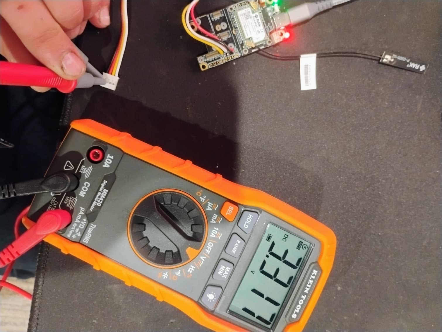

If the green light is off, you can check if the 3.3v is present. It can be that there are some short circuit caused by the connection you did.
I measured the voltage off of the VDD and the GND header, and also at the sensor connection point, and there is 3.3 volts at all the points I checked.

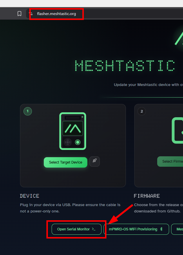

When I open the serial monitor, it only works when the sensor is disconnected. When I connect it and reboot, no logs come through, but it does still show up as a COM port.
