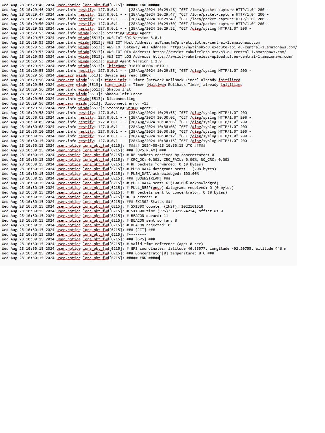

I have a RAK7267 that recognizes the SIM card(s) but doesn’t connect to cellular. I have tried both a T-Mobile and Hologram SIM with no luck. It also hasn’t updated the date/time either, related problem?
Here is the system log snippet if anyone can see anything:

No success, I tried the t-mobile sim with those APN settings, rebooted, and nothing. I tried the hologram sim with no success either.

Tue Jan 21 06:44:23 2025 user.info restify: 127.0.0.1 - - [21/Jan/2025 06:44:23] “GET /dashboard/lora/statistics HTTP/1.0” 200 -
Tue Jan 21 06:44:28 2025 user.info wisdm[5701]: Starting WisDM Agent…
Tue Jan 21 06:44:28 2025 user.info wisdm[5701]: AWS IoT SDK Version 3.0.1-
Tue Jan 21 06:44:28 2025 user.info wisdm[5701]: AWS IOT Host Address: as7cnaqfm7pfs-ats.iot.eu-central-1.amazonaws.com
Tue Jan 21 06:44:28 2025 user.info wisdm[5701]: AWS IOT Gateway API Address: https://nwtijs8xc8.execute-api.eu-central-1.amazonaws.com/prod/upload-api
Tue Jan 21 06:44:28 2025 user.info wisdm[5701]: AWS IOT OTA Address: https://awsiot-rakwireless-ota.s3.eu-central-1.amazonaws.com/
Tue Jan 21 06:44:28 2025 user.info wisdm[5701]: AWS IOT LOG Address: https://awsiot-rakwireless-upload.s3.eu-central-1.amazonaws.com/
Tue Jan 21 06:44:28 2025 user.info wisdm[5701]: WisDM Agent Version 1.2.11
Tue Jan 21 06:44:28 2025 user.info wisdm[5701]: ThingName 9181014C6041101011
Tue Jan 21 06:44:29 2025 user.err wisdm[5701]: device aes read ERROR
Tue Jan 21 06:44:29 2025 user.err wisdm[5701]: timer_init : Timer [Network Rollback Timer] already initilized
Tue Jan 21 06:44:29 2025 user.err wisdm[5701]: timer_init : Timer [Multiwan Rollback Timer] already initilized
Tue Jan 21 06:44:29 2025 user.info wisdm[5701]: Shadow Init
Tue Jan 21 06:44:29 2025 user.info wisdm[5701]: Succesfully connected to local MQTT broker!
Tue Jan 21 06:44:29 2025 user.info wisdm[5701]: local mqtt message: [sd_health_info] { “sd_status”: 0, “totalsize_m”: 15185, “freesize_M”: 15183, “free_percent”: 99 }
Tue Jan 21 06:44:32 2025 user.info restify: 127.0.0.1 - - [21/Jan/2025 06:44:31] “GET /net/wan?details=y HTTP/1.0” 200 -
Tue Jan 21 06:44:32 2025 user.info restify: 127.0.0.1 - - [21/Jan/2025 06:44:32] “GET /net/wan/stats HTTP/1.0” 200 -
Tue Jan 21 06:44:34 2025 user.err wisdm[5701]: failed ! mbedtls_net_connect returned -0x52
Tue Jan 21 06:44:34 2025 user.err wisdm[5701]: Shadow Connection Error
Tue Jan 21 06:44:36 2025 user.info wisdm[5701]: Disconnecting
Tue Jan 21 06:44:36 2025 user.err wisdm[5701]: Disconnect error -13
Tue Jan 21 06:44:36 2025 user.info wisdm[5701]: Stopping WisDM Agent…
Tue Jan 21 06:44:39 2025 user.info restify: 127.0.0.1 - - [21/Jan/2025 06:44:39] “GET /net/wan/intf/cellular HTTP/1.0” 200 -
Tue Jan 21 06:44:50 2025 user.notice lora_pkt_fwd[6395]: ##### 2025-01-21 06:44:50 UTC #####
Tue Jan 21 06:44:50 2025 user.notice lora_pkt_fwd[6395]: ### [UPSTREAM] ###
Tue Jan 21 06:44:50 2025 user.notice lora_pkt_fwd[6395]: # RF packets received by concentrator: 0
Tue Jan 21 06:44:50 2025 user.notice lora_pkt_fwd[6395]: # CRC_OK: 0.00%, CRC_FAIL: 0.00%, NO_CRC: 0.00%
Tue Jan 21 06:44:50 2025 user.notice lora_pkt_fwd[6395]: # RF packets forwarded: 0 (0 bytes)
Tue Jan 21 06:44:50 2025 user.notice lora_pkt_fwd[6395]: # PUSH_DATA datagrams sent: 1 (209 bytes)
Tue Jan 21 06:44:50 2025 user.notice lora_pkt_fwd[6395]: # PUSH_DATA acknowledged: 100.00%
Tue Jan 21 06:44:50 2025 user.notice lora_pkt_fwd[6395]: ### [DOWNSTREAM] ###
Tue Jan 21 06:44:50 2025 user.notice lora_pkt_fwd[6395]: # PULL_DATA sent: 6 (100.00% acknowledged)
Tue Jan 21 06:44:50 2025 user.notice lora_pkt_fwd[6395]: # PULL_RESP(onse) datagrams received: 0 (0 bytes)
Tue Jan 21 06:44:50 2025 user.notice lora_pkt_fwd[6395]: # RF packets sent to concentrator: 0 (0 bytes)
Tue Jan 21 06:44:50 2025 user.notice lora_pkt_fwd[6395]: # TX errors: 0
Tue Jan 21 06:44:50 2025 user.notice lora_pkt_fwd[6395]: ### SX1302 Status ###
Tue Jan 21 06:44:50 2025 user.notice lora_pkt_fwd[6395]: # SX130X counter (INST): 122663842
Tue Jan 21 06:44:50 2025 user.notice lora_pkt_fwd[6395]: # SX130X time (PPS): 122465501, offset us 0
Tue Jan 21 06:44:50 2025 user.notice lora_pkt_fwd[6395]: # BEACON queued: 4
Tue Jan 21 06:44:50 2025 user.notice lora_pkt_fwd[6395]: # BEACON sent so far: 1
Tue Jan 21 06:44:50 2025 user.notice lora_pkt_fwd[6395]: # BEACON rejected: 0
Tue Jan 21 06:44:50 2025 user.notice lora_pkt_fwd[6395]: ### [JIT] ###
Tue Jan 21 06:44:50 2025 user.notice lora_pkt_fwd[6395]: #--------
Tue Jan 21 06:44:50 2025 user.notice lora_pkt_fwd[6395]: ### [GPS] ###
Tue Jan 21 06:44:50 2025 user.notice lora_pkt_fwd[6395]: # Valid time reference (age: 0 sec)
Tue Jan 21 06:44:50 2025 user.notice lora_pkt_fwd[6395]: # GPS coordinates: latitude 46.83583, longitude -92.20743, altitude 440 m
Tue Jan 21 06:44:50 2025 user.notice lora_pkt_fwd[6395]: ### Concentrator[0] temperature: 12 C ###
Tue Jan 21 06:44:50 2025 user.notice lora_pkt_fwd[6395]: ##### END #####
