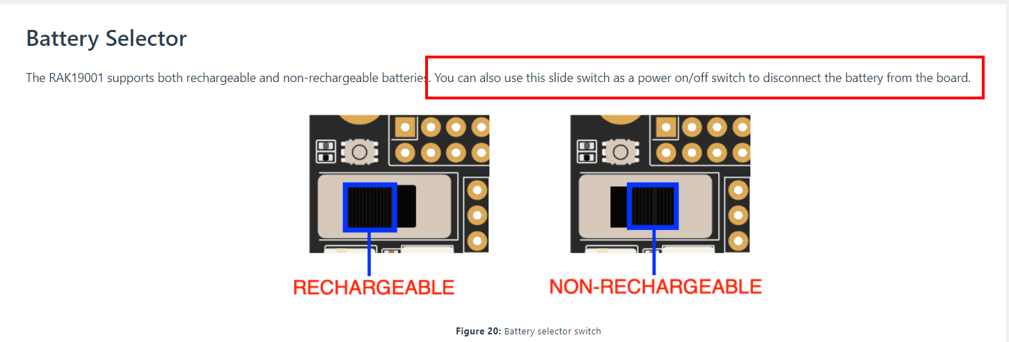

I am not confident that there will be a switch by default on all WisBlock Baseboards in our WisBlock Roadmap.
However, we have one model that has a switch selector for battery type. That is the RAK19001 Dual IO Baseboard. You can use this switch as an ON/OFF switch.
