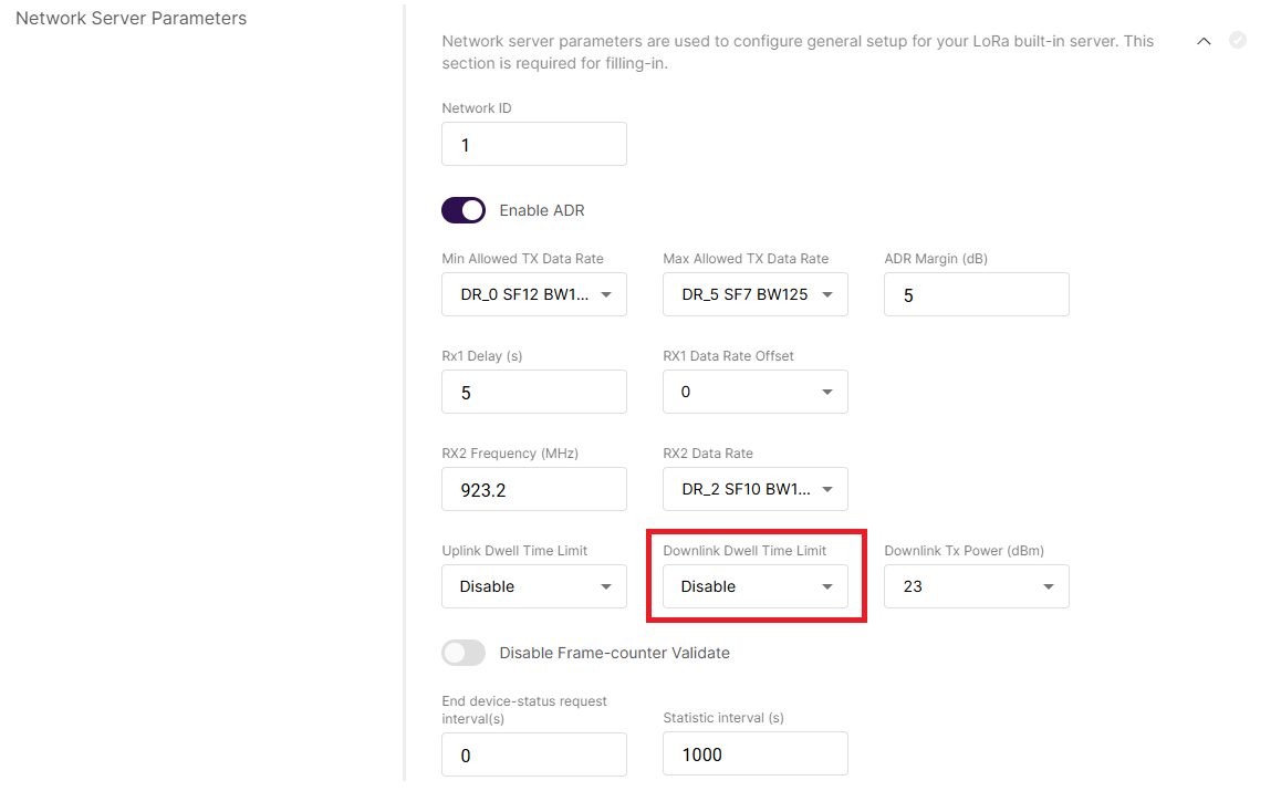

This is my configuration for Gateway.

I think it related to the dwell time (400ms) of region AS923.
Then I tried to disable the Downlink Dwell Time Limit configuration, but it still not work.
Please help me resolve it.
