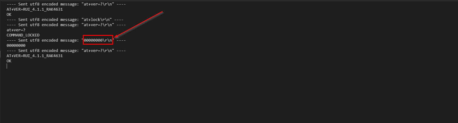

Hi All,
I was trying out the AT+LOCK command and the serial and ble uart are locked (which is working), but while trying to unlock it with the default password (‘00000000’) it still says ‘COMMAND_LOCKED’. Also, can’t upload any new firmware as it shows “no ping response” while uploading.
I haven’t changed the password at all.

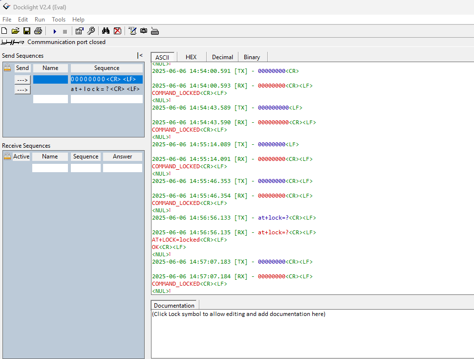

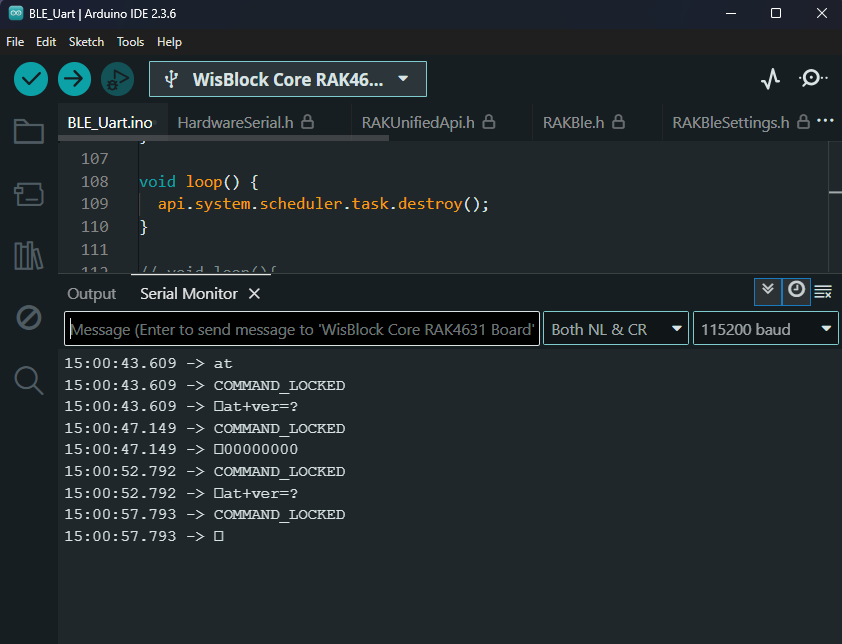

Hello,
I am using a trailing CR/LF but still it shows ‘COMMAND_LOCKED’
sharing below ss from arduinoIDE and docklight
Is there a way to reset everything?

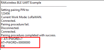

I was able to put the device in boot mode via pressing the reset button twice.
I wrote a test code to just init Serial and blink LED_BLUE and unlock via “api.system.pword.unlock();”
after unlocking I checked the existing password via “AT+PWORD=?” command and it returned the password which I had used to set the ble pin with via “api.ble.uart.setPIN(pairing_pin, 6);”.

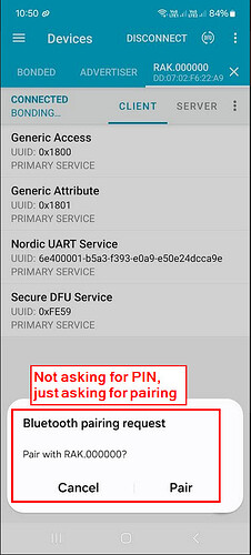

Interestingly enough it wasn’t asking me for a pin when connecting with ble as shown in the example here
@beegee any update on why the api.ble.uart.setPIN would change the serial password and not ask for pin on pairing via serial bluetooth terminal app.
I am setting permission as api.ble.uart.setPermission(RAK_SET_ENC_WITH_MITM), basically using the ble uart test code.
Using the BLE-UART example code, the device asks for pairing on the first connection.
Future connection will not ask anymore, as the device and the phone are already paired.
However, it does not ask for the pin. I opened a ticket about this with our R&D team.
For the second issue, that the serial password is changing to the BLE pin, I cannot reproduce this.
