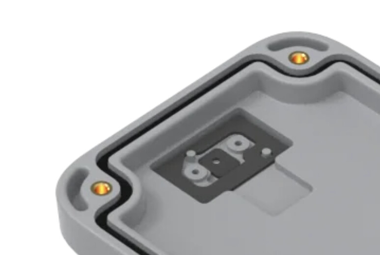

In order to allow the audio into the case you need to drill a hole in the case and mount the microphone in/over this hole. Then, in order to keep the IP67 rating you will need a membrane that passes the audio and keeps the water out.
If you didn’t need the solar panel the obvious solution would be to use the Unify enclosure that is designed to accept a microphone (it has the hole, membrane and gaskets).
In the image below there is a membrane hidden below the gasket with the round hole in it.
