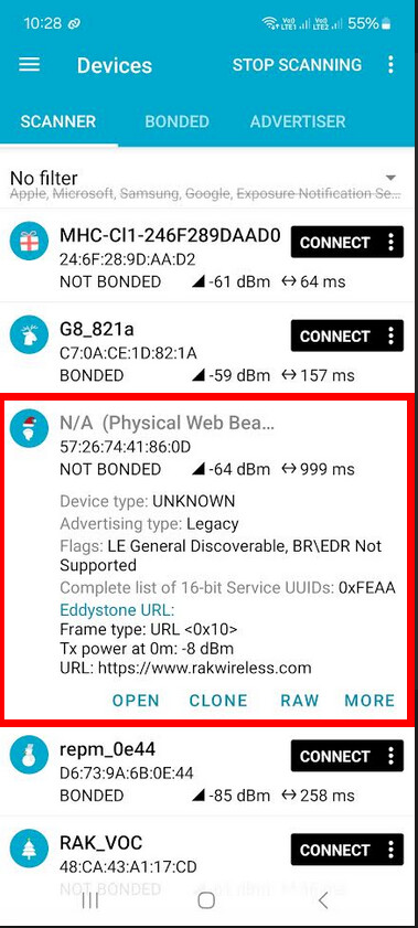

Compiling and flashing the custom payload beacon example I can see the beacon and it’s advertised data in nRFConnect.
I can’t say anything about the ESP32-C3, I don’t have that MCU. But using our RAK3112 ESP32-S3 as beacon scanner Beacon_Scanner.ino, I can see the RAk11720 beacon.
