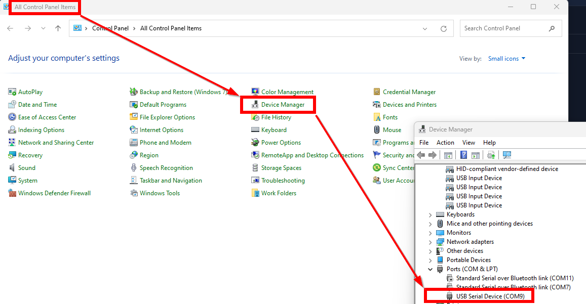

If you plug in the RAK4631 to the USB port, does it give you a sound and does it assign a COM port to it?
You can check in the Device Manager if a new COM port is showing up.

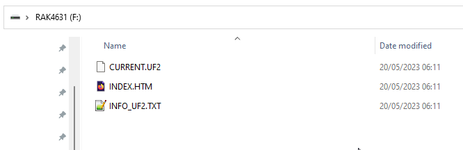

If you double push the reset button while the board is plugged in, do you get a new drive called RAK4631

It is assigned a COM port. In fact I’ve changed it as a test to it saying the port was busy. I currently have it on 8. If it DFU mode is COM5. When it DFU mode, file explorer does pop up with those 3 files as shown in your screenshot.

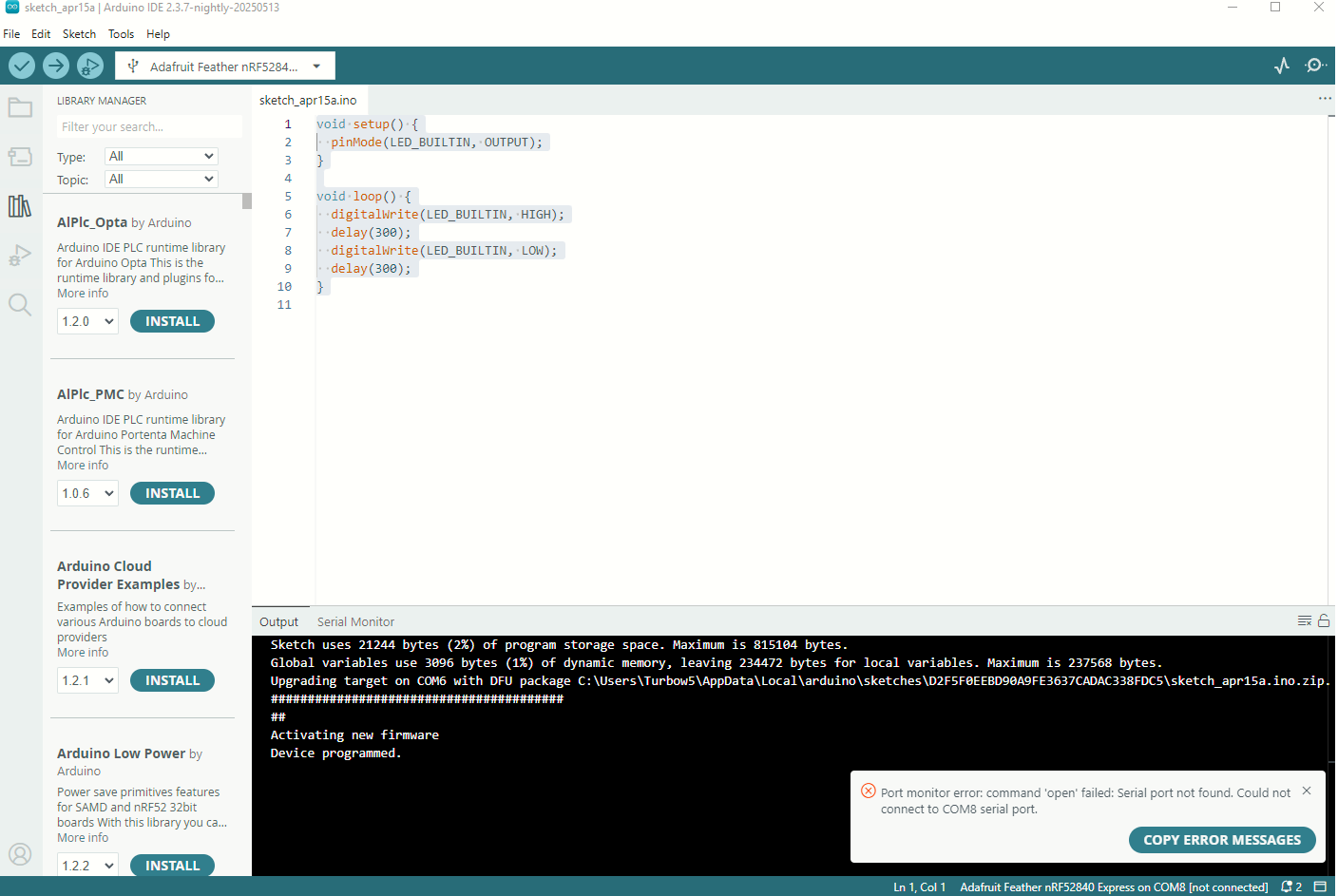

So I uninstalled it, deleted the libraries, then installed the portable version, and I’m back to this (screenshot). Where it says upload successful, but at the same time says cant access the COM port. And the board isn’t blinking at all.
Edit: I just noticed the screenshot says it uploaded to com6 and not 8, so I plugged the 4631 back in, and now it’s not even showing up under device manager (but does have a solid red light) . But now it’s making a sound of… a high pitch then low pitch, repeating. So I double tap the button, goes into DFU mode, I see it on COM5, try to upload a different script, thinking maybe what I posted was wrong. Still got that error of failed to open COM.

so I’ve used the Adafruit and Wisblock for testing, and it doesn’t get rid of any error. I’ve changed the code, used the simple examples that come with Arduino, but it’s stuck. Is there a way to tell if the board is faulty/locked up?

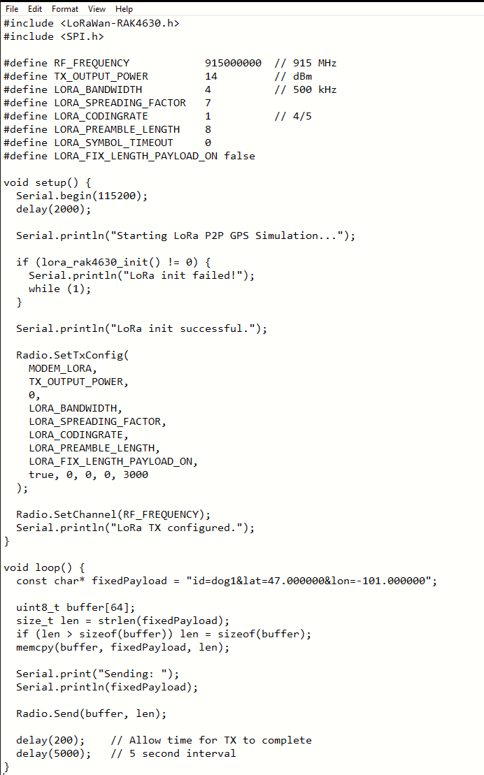

Ok I can see it getting a GPS fix and TX over LoRa. Cool. So I tried to upload my own script and it said upload successful, but then got that message of “was unable to get success message from com”. Maybe it’s the code I’m uploading?
Maybe you can share your code here as “text”.
I am too lazy to type everything from your screenshot to try it.
I’d love to but txt is not an option, and new users can’t upload docx, and there’s no option for ZIP…So…I’ll paste it here. (this pasted really clean. if I knew this I would have pasted here sooner)
#include <LoRaWan-RAK4630.h>

You are missing a few essential things in your code.
(1) No event callbacks, they are needed to handle RX/TX/CAD/… events of the LoRa transceiver
(2) You skipped the radio initialization
Here is a working version of your code:
