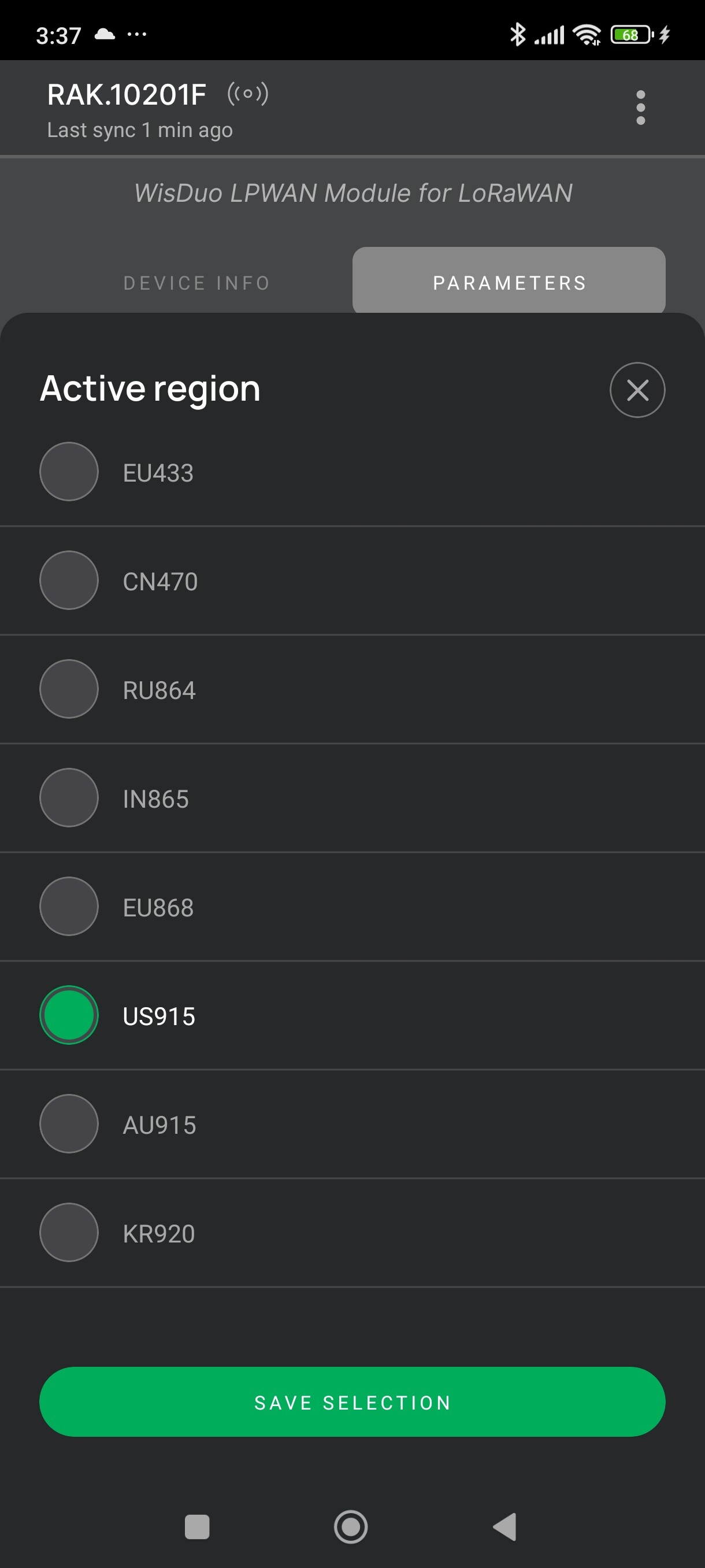

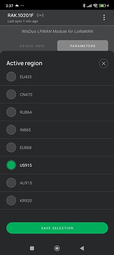

I wanted to confirm if you made the region change in the application wistoolbox a AU915. The rak4631 would work with the AU915 frequency gateway.
When we acquired the rak4631 modules we selected US915. But I see that from the application it lets me change it and I have seen that this frequency is very similar to AU915.
Best regards
Yes you can change the LoRaWAN regions as long as the rest of the network (Gateway and LoRaWAN server) are setup to the same region as well.
