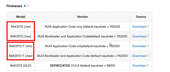

  1. On your website, I only see firmware for RAK3172-E. If I flash RUI_4.2.1_RAK3172-E on my RAK3172-T board, will it work properly? Or is there a separate firmware for the -T version?
  2. From the factory, my new RAK3172-T board already has DevEUI, AppEUI, and AppKey stored. Can I directly use these values for my production deployment with TTN, or is it recommended to generate new ones in TTN?

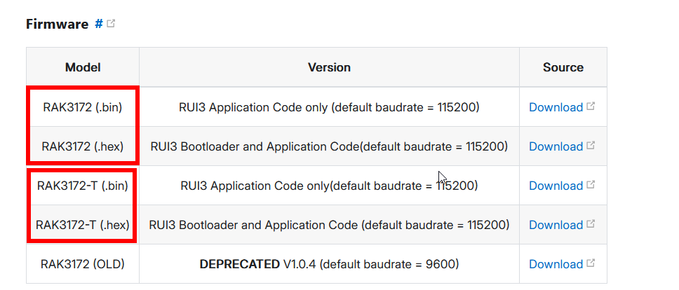

The two firmware are listed in the docs Firmware
But I agree, there is no clear guide which firmware to use with which variant of the module. I will forward this to our documentation team.
If you flash the firmware for the RAK3172 without TCXO, the LoRa transceiver will not be able to work properly, because the timing is off.

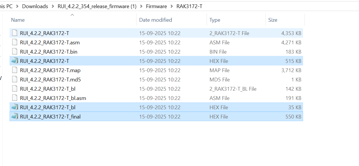

There is 3 files has same name with RUI_4.2.2_RAK3172-T,RUI_4.2.2_RAK3172-T_bl,RUI_4.2.2_RAK3172-T_final. which one is final?
RUI_4.2.2_RAK3172-T_final this one is final?
Same for RUI_4.2.2_RAK3172-E, RUI_4.2.2_RAK3172-E_bl, RUI_4.2.2_RAK3172-E_final. which one is final?
RUI_4.2.2_RAK3172-E_final?
Hi @Prasanna ,
The one with _final.
On your image, that’s the last one.
