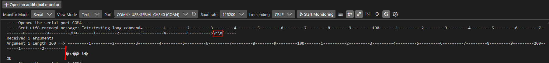

The limit seems to be ~230 characters.
I tested multiple serial terminals and the parameter after the command itself is cut off at 230 characters, but the parameter length is reported as 260 bytes (that could be a bug in RUI3)
Test command with 25 char long command and 260 byte long parameter:
atc+testing_long_command=---------1---------2---------3---------4---------5---------6---------7---------8--------9---------100-------1----------2---------3---------4---------5---------6---------7---------8---------9---------200-------1---------2---------3---------4---------5---------6

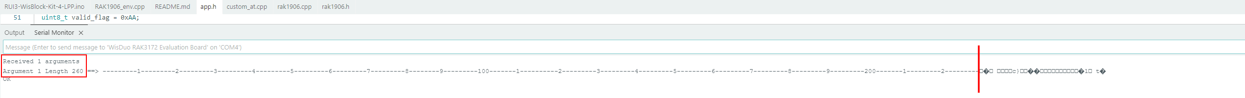

Testing with the Serial Monitor of Visual Studio the parameter is cut off at 230 bytes:
The Serial Monitor of the ArduinoIDE has a similar behaviour, the parameter is cut off at 230 bytes.

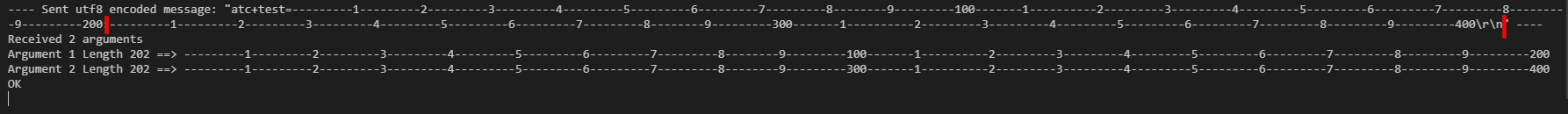

If I split the parameter into two parameters of 200 characters each, all is good:
atc+test=---------1---------2---------3---------4---------5---------6---------7---------8--------9---------100-------1----------2---------3---------4---------5---------6---------7---------8---------9---------200:---------1---------2---------3---------4---------5---------6---------7---------8--------9---------300-------1----------2---------3---------4---------5---------6---------7---------8---------9---------400
Command = atc+test=
Parameter 1 = ---------1---------2---------3---------4---------5---------6---------7---------8--------9---------100-------1----------2---------3---------4---------5---------6---------7---------8---------9---------200
Parameter 2 = ---------1---------2---------3---------4---------5---------6---------7---------8--------9---------300-------1----------2---------3---------4---------5---------6---------7---------8---------9---------400
