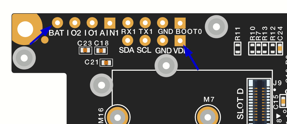

Is there a test pin or pad for measuring the VDD?
Hi @KY6O ,
These points are at the back.
Thanks, I will do this tonight.
PS: After all the electronics courses I took in school, I’m personally embarrassed that I didn’t turn the board over to look there first.
