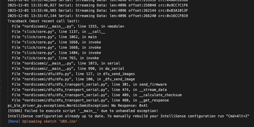

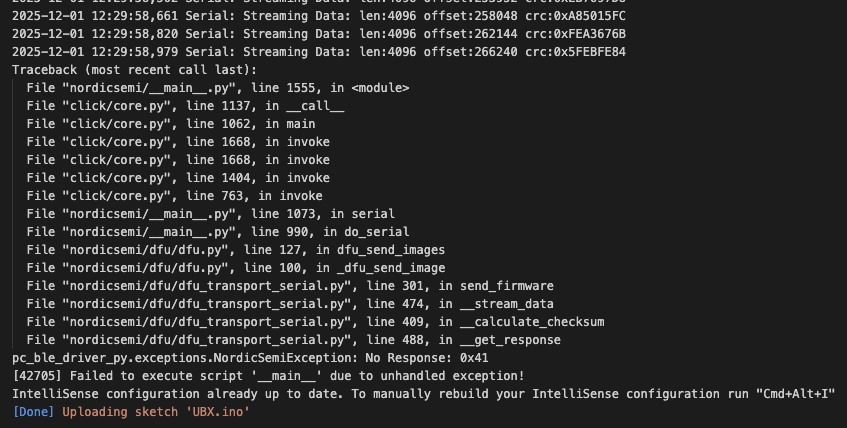

I’m getting a lot of these lately. The loading is over USB, so BLE shouldn’t come into it at all.
Often I can get around the problem just by changing some trivial thing like the exact text inside a println(). I do this to force a change in the CRC for each block and it mostly works.
Does anyone know what the real issue is?
Trivially modified code to generate changed CRCs, different hardware in case a flash memory cell had died, but load failing in the exact same place with the same error.

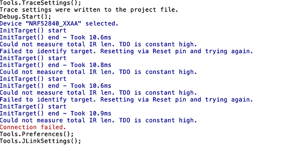

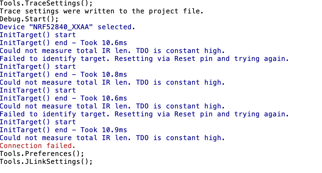

Back in April what I thought I did was open the RAK4631-RUI3-V4.1.1-Flash-Dump.hex in Ozone, set the processor to nRF52840 in the Jlink settings and click on
“Download and Reset”. This time around it is complaining that TDO is stuck high - which it is because the 4631 module doesn’t bring it out to the header, only SWDIO. But since TDO is only needed for trace it shouldn’t matter. I don’t recall this behaviour last time.
