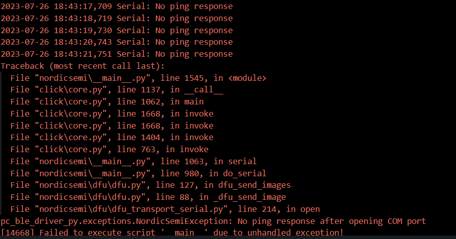

Hello , so I have a Rak4631-R , and I’m trying to upload code there via arduino IDE but this error keeps happening
Can you share the complete log output from Arduino IDE.
Hello,
I can send it later but it doesnt have much more,it just has more “no ping response” and the very first line of the error says “no application image”
Connect through the terminal, send AT+BOOT and then try to upload again.

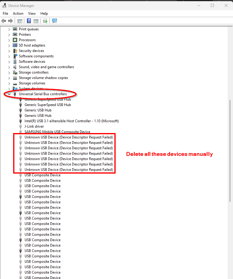

I had a case where Windows blocked a WisBlock module (never found out why).
The solution was to
- open Control Panel
- go to Device Manager
- in the View Menu, enable “Show hidden devices”
- Open the “Universal Serial Bus controllers” list and delete manually all devices that are listed as “Unknown USB Device …”
Then I had to reboot the computer.
