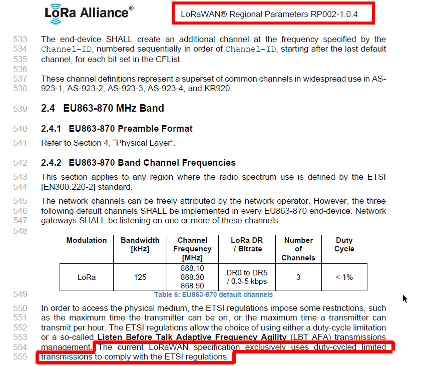

Our LoRaWAN stack is based on LoRaWAN Regional Parameters RP002-1.0.4.
It is not mandatory and it would be even outside of the LoRa Alliance specification.

yes I saw that before. Lorawan Alliance spec currently restricts spectrum usage far more than ETSI which is probably for effort reasons (regionality).
At the end I only have to fulfill ETSI.
