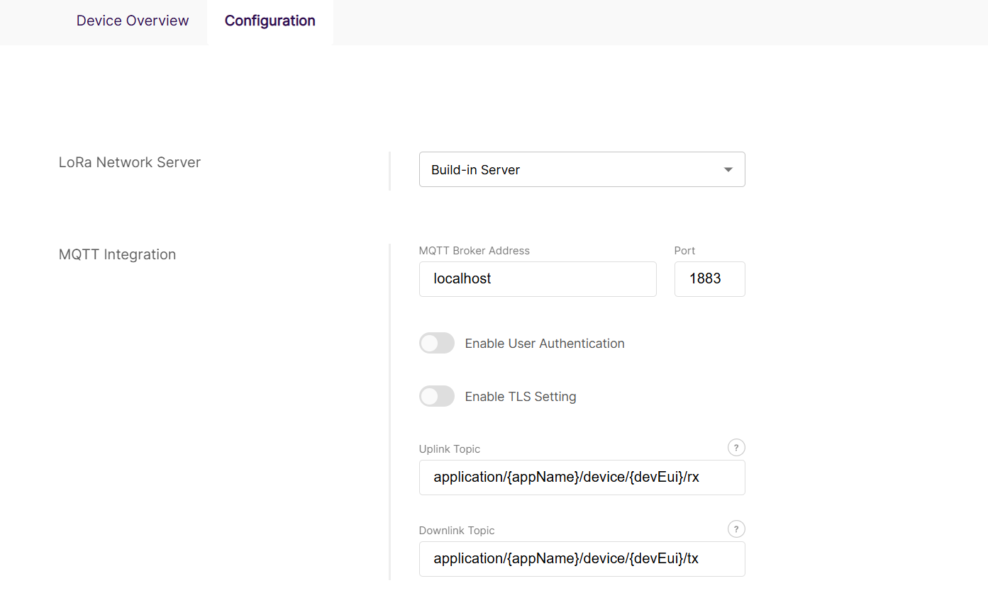

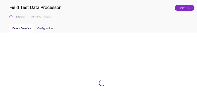

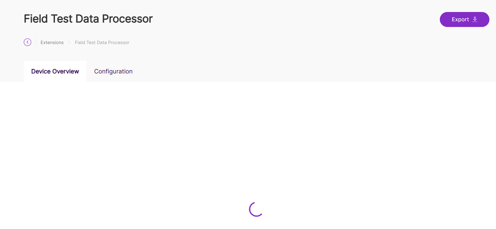

Hi all. I was testing using RAK Tester, and it was working fine some time ago. Recently I noticed is not loading up anymore. And tester also does not produces Uplink.
Hi @mucflyer ,
The Device Overview takes sometime to shows up. Then if you have no recent data, there will be nothing to show at all.

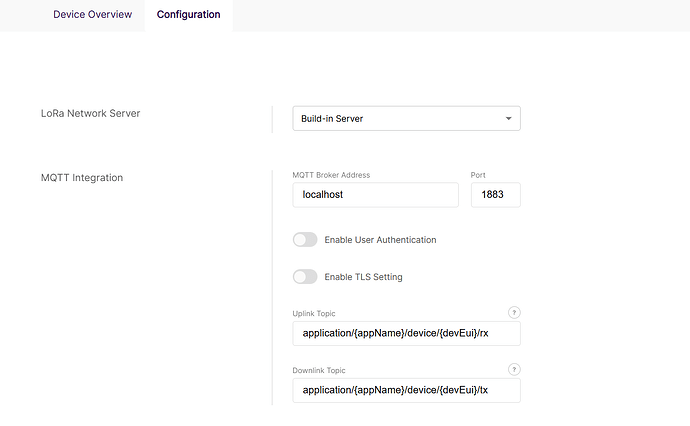

On your Configuration tab, you are using built-in LNS. Is that correct?
The field tester uplink interval has nothing to do with the Field Data Processor extension. So it is a different problem. Is it joined correct? Haven’t you clicked the pause button? What is the uplink interval you set? If you are joined successfully, there must be a time indicator on the Field Tester LCD touchscreen interface.
