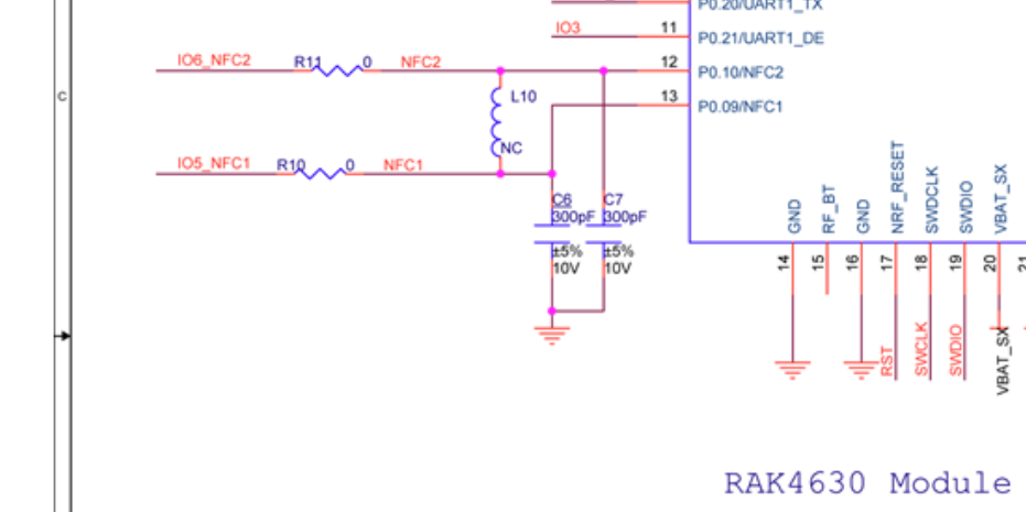

Welcome to the forum @DoubleU
The NFC is NOT provisioned, as you can see that L10 is NC (== not assembled).
Where did you see this? It is incomplete. On A RAK19007 it is Slot A or Slot D. On a RAK19003 Base Board, it is slot C. All of these slots can hold a long module.

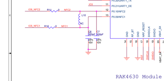

since the GPS works fine in A or C and not D, I was looking at the datasheet and the schematics for a delta compared to the other slots,
I observed that most pins are the same (RX, TX i2c,…) execpt the two IO pins (used to enable the GPS) also I noticed the capacitors and coil (nc).
In firmware all 3 slots are probed (by enabling the device and query the module). The module is detected, while GPS is disabled in the settings the device is reponsive, when enabled the device becomes unreachble (it does not lock-up fully, BT led keeps blinking, BLE adverts arrive but up on connecting it generates a timeout. I also tried flashing the USB companion firmware but there it behaves the same.
