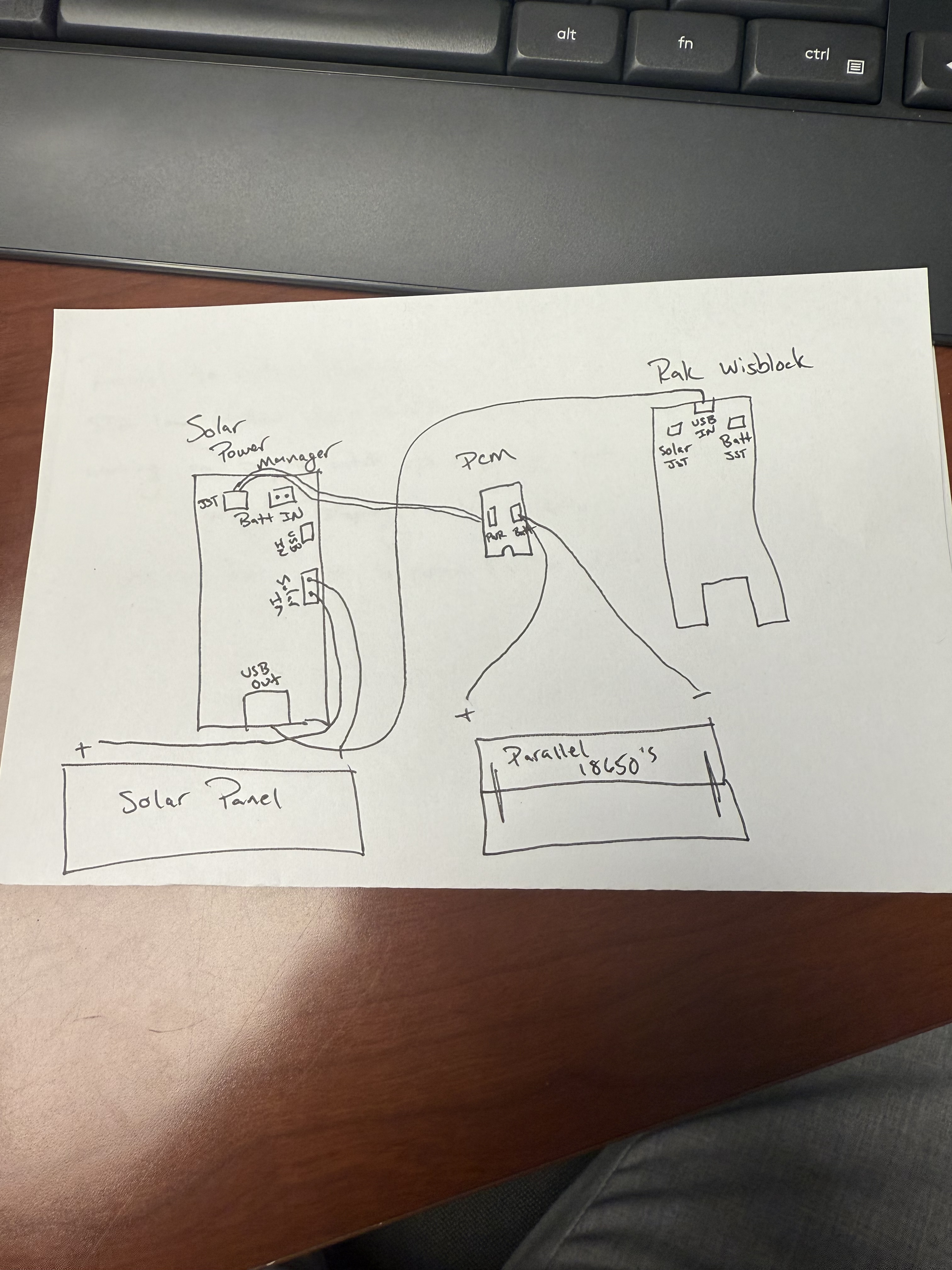

To piggy back of this thread, let’s say I’m installing a solar power controller on the wis block and also adding a standalone in-line PCM. What would be the proper way to wire this to make it as efficient as possible?
Im trying to make the current flow make sense in my head before attempting to wire. This is what I came up with but not sure if correct?
Looks ok. But if your Solar Power Manager has a direct 5V output, you could use that to connect to the Solar connector of the WisBlock Base Board instead. Will use smaller connectors (JST) instead of the large USB connectors.
It just has a usb 5v output no jst connections. This particular board anyway. I’d have to look into others that support both.
