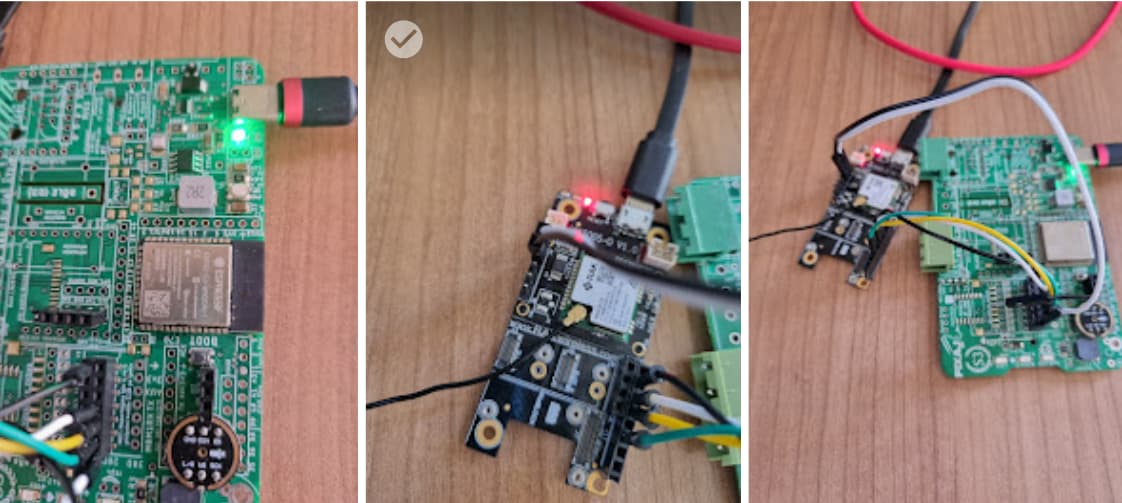

my circuit
also uart is woking good. I can send data each other esp32 to rak.

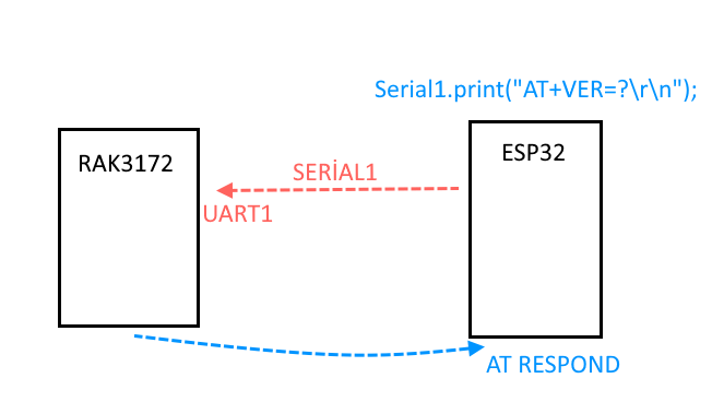

Yes I understood at least. schematic should like this. if esp32 send at command over the serial1 to rak3172’s serial1. rak will retrun the respond on serial1 again.
