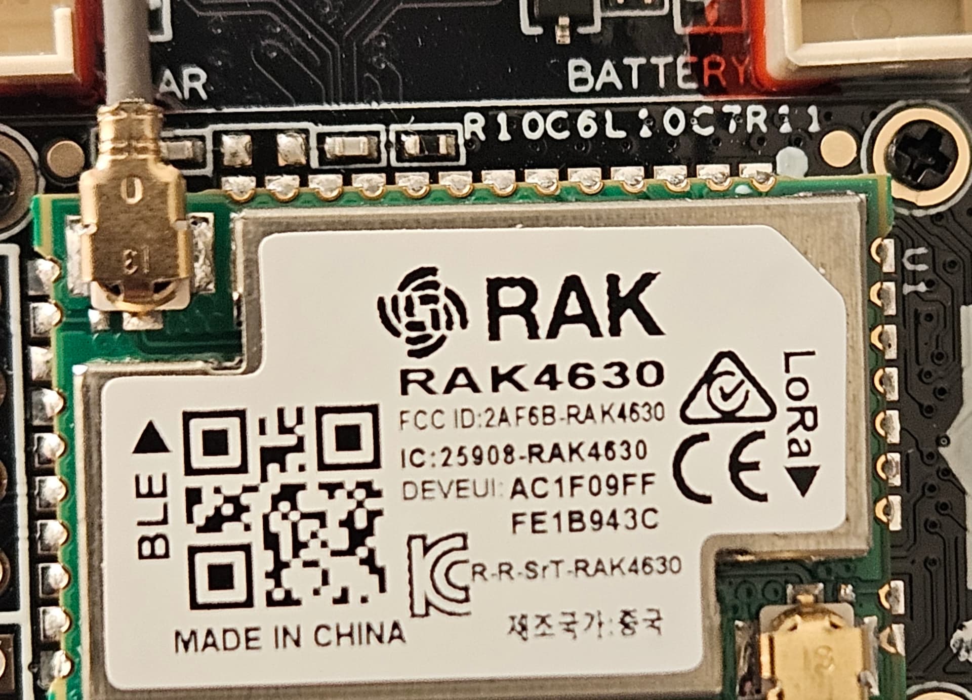

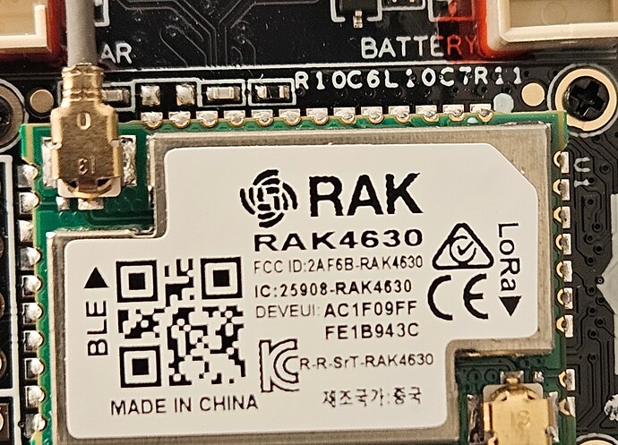

Hi, how can i check for what frequency the RAK4630 is manufactured? I am searching for some sort id marking is for 434 or 868 mhz?

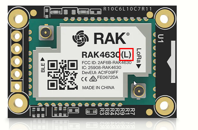

If you don’t have the (L) marking on the label, the modules LoRa transceiver is working for both 8xx and 9xx MHz LoRa.
But you still have to choose the correct antenna for the frequency you will use.
