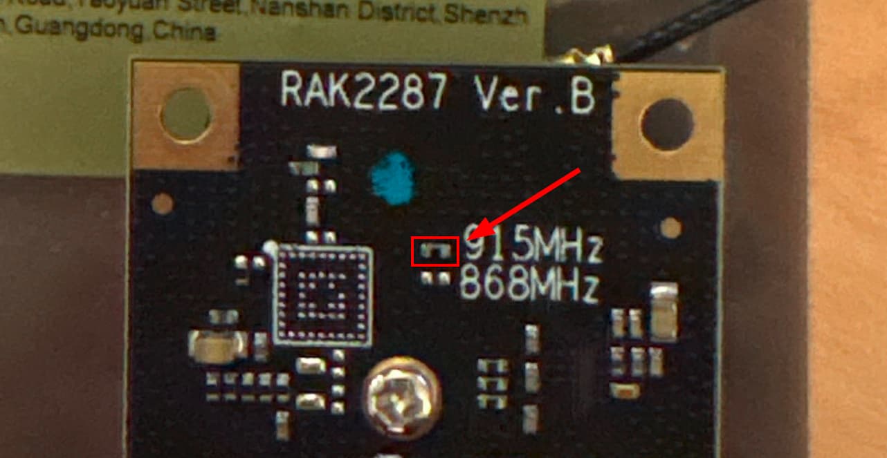

Hello Bernd, I had the same issue in differentiating the concentrator regions. How to differentiate an assembled resistor from an unassembled one? I have attached my concentrator’s picture could you verify which version is it? Thank you.
As you can see (maybe with a magnifier), there is a resistor soldered next to the text 915MHz.
That means it is a 915MHz version.
Just changing the resistor does not mean that the concentrator works on the other frequency range, there are other differences.
But concentrators are not my domain, I can’t tell you the exact differences between a 915 and a 868 MHz concentrator.
