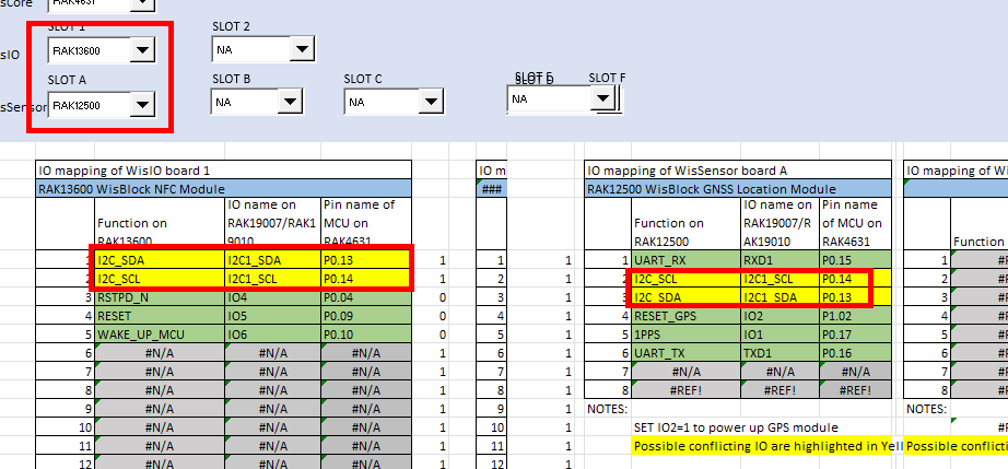

I need to develop a sensor that reads NFC, Mifire, etc., and I’m planning to use a RAK13600. However, I’ve also been asked to send GPS coordinates, and I’m thinking of using a RAK12500.
But after checking, both sensors use I2C, and I see that I have conflicts in the mapper.
I’d like to use an I2C usage strategy where the tasks are separate and not performed simultaneously. If they’re not performed at the same time, it might work.

You can use I2C pins together. To avoid other possible conflict, use SLOT A for the RAK12500.
