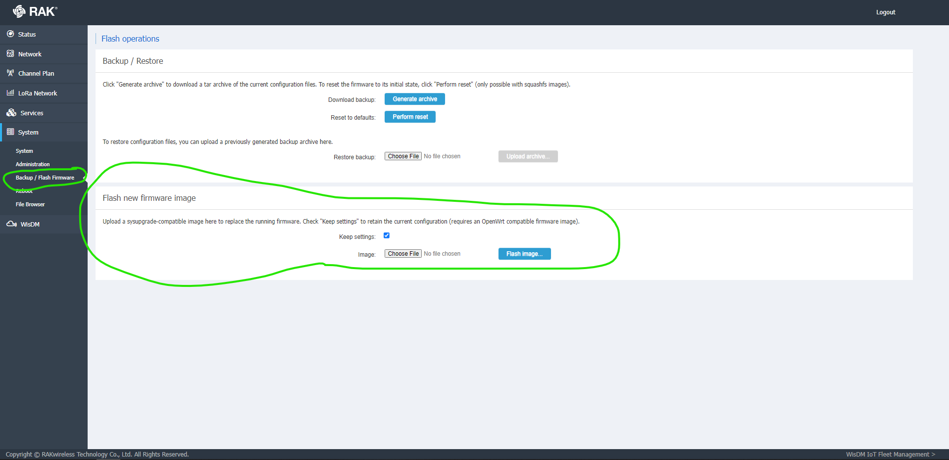

You can not insert files in the system because it is read-only, this is done that way because we have limited memory and that is why you can not upload files on it. What is the exact use case that you want to realize?
