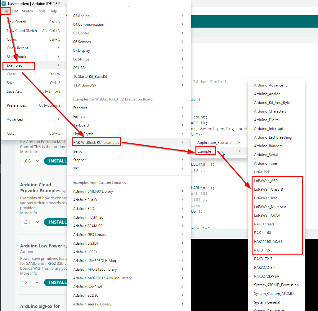

If it works with AT commands, then there is no hardware problem.
Plenty of examples in the RUI3-Best-Practices repo and the BSP itself has as well examples.
