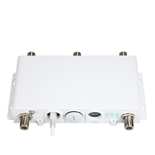

Hi everyone, just wondering if it’s possible to find the 4g modem model in my gateways? Just wanting to check the frequency bands as 3g is being deprecated in our part of the world and I need to make sure that the gateways will still work with 4g…I’m running mainly rak 7240’s…
