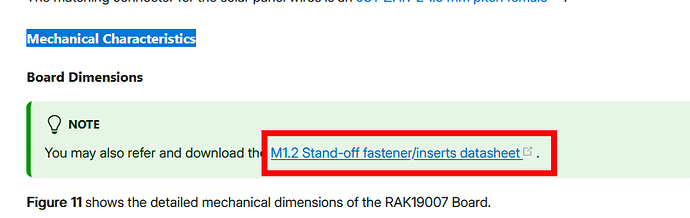

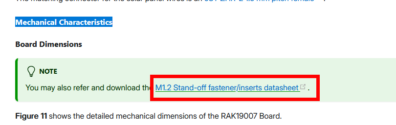

Can you perhaps ask internally about the PCB press fit inserts? My PCB Fab house can autoload them if I can provide them with a manufacturer’s part number.
It is actually in our documentation (I forgot)
RAK19007 - Board Dimensions
M1.2_Press-Fit_Standoff_Datasheet.zip (505.8 KB)
Perfect! Not sure why I also didn’t see this before. Thanks for correcting my eyesight :slight_smile:
