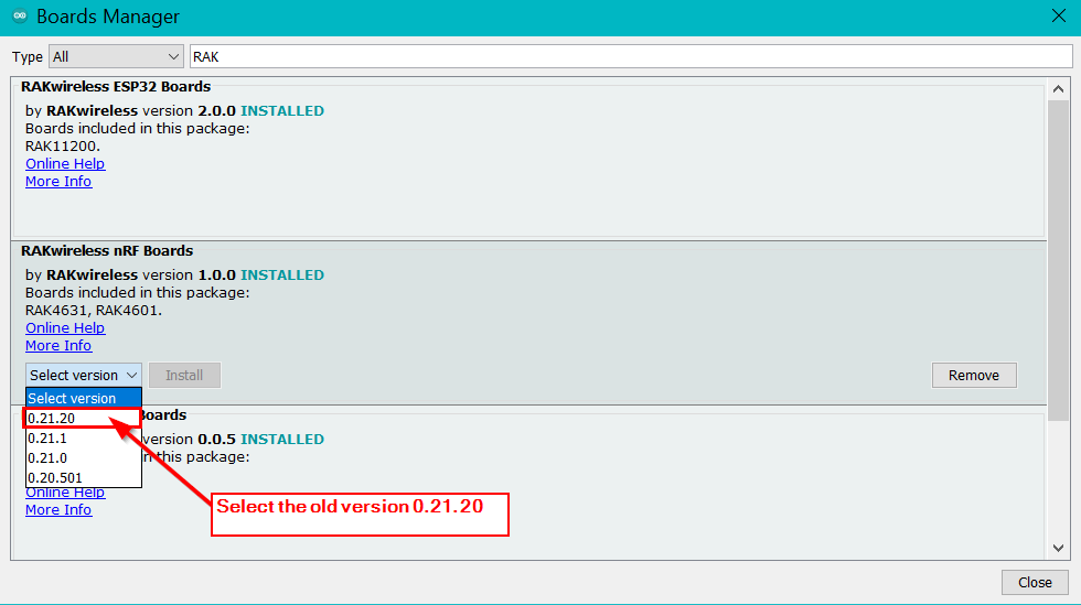

Hey has the bin folder /Users/will/Library/Arduino15/packages/rakwireless/tools/arm-none-eabi-gcc/9-2019q4/bin/arm-none-eabi-g++ but the file arm-none-eabi-g++ is missing. What do we need to do to fix this? We have tried uninstalling/reinstalling and reverting back the nRF Modules, none of those worked

I tried following these steps beegee recommended on my own computer to see if I could get the updated version, unfortunately it did not work. I was hoping if I could get the updated software maybe it would solve my connection issues. Here is my traceback when I tried removing all those folders and files and re installing.

I believe in the past when I have re installed the arduino app on mac os all the packages were still there and everything was the same. Are there some other folders I need to delete as well? Ugh I do but all my work is running on linux ubuntu 21.04, I am going to give that a shot
Great news, I was able to get the newest update running on ubuntu 21.04. We are about to test it for my friends mac clearing the code. His worked as well but we didn’t try the newest update, we played it safe and did 21.20 since he is on a mac
