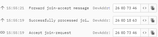

Hi,
I am using sx1262_Arduino library I have made few modifications according to my requirement, I face an issue in connecting to TTN and here’s the screenshot. Also i’ve noted that the loraMacInitializationTime is 0.
How do i resolve this?

I don’t see a problem in your screenshot?
What changes did you make to the library?

The RAK module used is RAK4631. However we are unable to push the data to TTN network server. As in earlier screenshot no payload is transmitted after the forward join-accept message.
