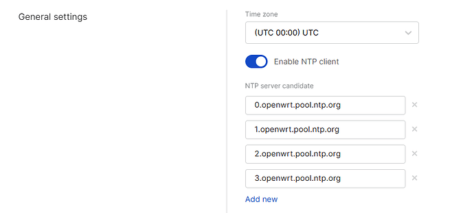

Hey there, I am trying to figure out a time sync log that is all over my gateway log at the moment. I am trying to configure and use basic station for the first time so I am not sure if this is an issue or not. I am seeing the following log repeatedly, and like A LOT - every couple of seconds.
Thu Apr 24 19:40:58 2025 user.err basicstation[6174]: [SYN:ERRO] transfer error, due to ppsSync.pps_xtime = 0
I was trying to read up on it and I understand there is some time sync problem, but not sure where or how to fix this? Or shut it off if it isn’t needed?
I am using a Chirpstack v4 instance, with basic station - EU868. Gateway model is RAK7268CV2.
NTP Time Sync is on, but I am only using the defaults from WisDM/the gateway.
Thanks!
