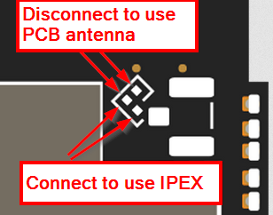

If you are good in soldering small parts, you can cut off the PCB antenna (move a 0Ohm resistor to a different position) and solder an IPEX connector:
That would be great, soldering an IPEX connector should not be a problem, I have the skills and equipment to do it. Just to make sure - I need to cut those two traces and solder the connector to those two pads?

No need to cut anything
(1) rotate the resistor from its original position for 90 degrees:
to
(2) solder the IPEX connector on the pads
Not sure (never did it), it might be easier to do (2) first and then just remove the resistor and place a solder bridge
Now I get it, thanks for the explanation! Just ordered some IPEX connectors, in the meantime I will order the devices from RAK and will try it, hopefully it will work.

If I may add something here - I have followed the instructions from Bernd and it works like charm, thanks again for the support!

Seems the resisor can just be removed or is there a solder pad I’m not seeing for rotation it?
Detailed view. There are three solder pads.

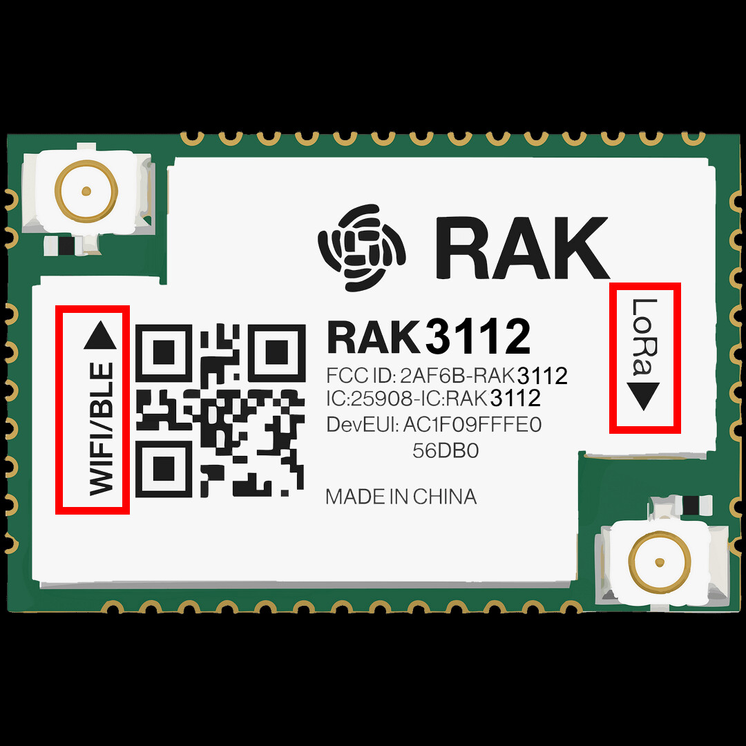

Don’t rely on the RAK11200 to be available forever. The ESP32 WROVER is EOL.
Coming soon RAK3312 WisBlock Core Module with ESP32-S3 and integrated SX1262 LoRa transceiver.
