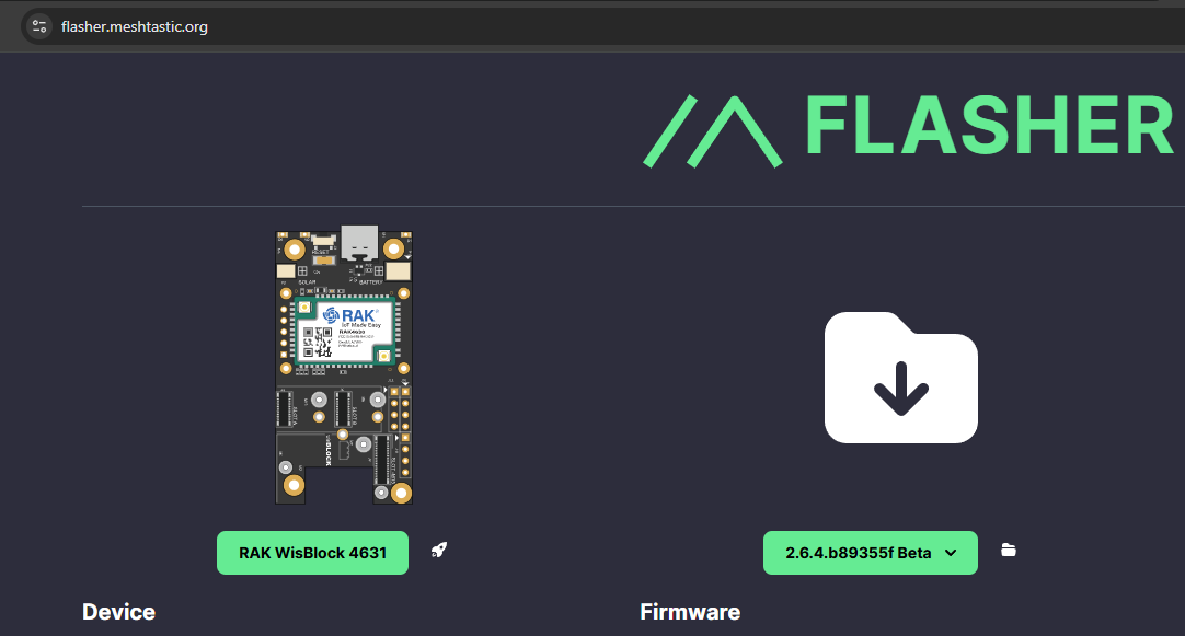

Hello Guys,
I have similar issue with WisMesh Ethernet MQTT Gateway with * **[WisBlock RAK4631 Core Module] and POE * WisBlock RAK13800 Ethernet Module
I am not able to connect via ethernet thru (http/https) https://client.meshtastic.org/
Anyway I can connect via python client “meshtastic --host 192.168.1.197 --info” or android app via network. Why I can’t via web client and how to solve it ?
I am using latest meshtastic firmware:
Welcome back to the forum @Tomahawk
Only ESP32 module supports web client interface.
You have to talk to Meshtastic about this. We are not developing or maintaining the Meshtastic firmware.
Thank you Beegee! Then this is about the firmware that neeed to handle web requests i guess…
