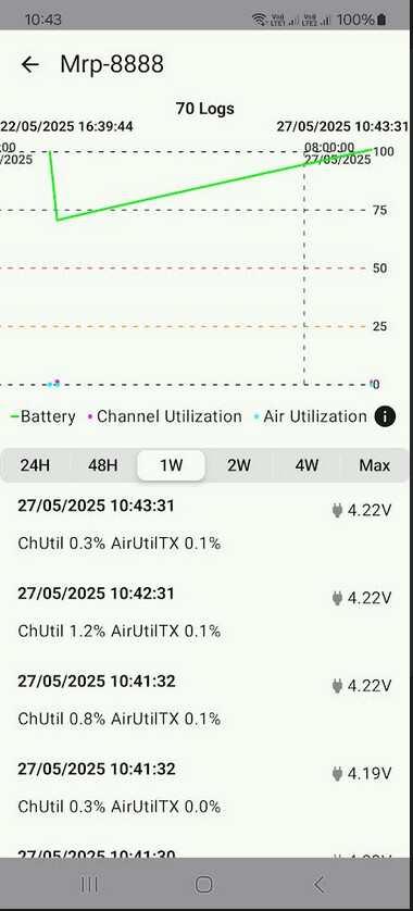

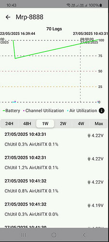

I am getting the data in the Meshtastic app:

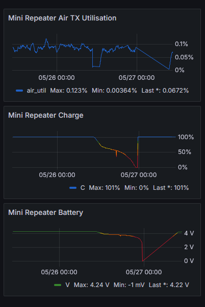

And I am seeing them in MQTT:

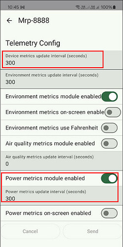

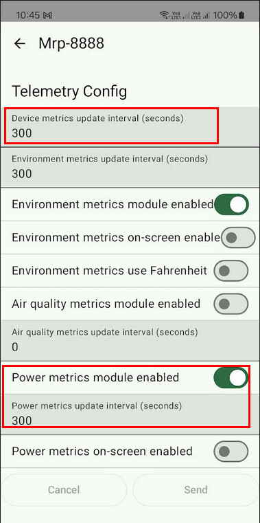

Check your telemetry settings:
If that doesn’t help, I can’t help you with this. Please ask Meshtastic.

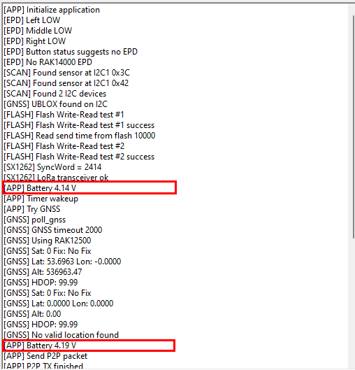

Please flash attached Hardware Test Firmware on the device that does not report battery values.
This test firmware is NOT Meshtastic. It is a test firmware we developed to run a basic test of a WisBlock device.
Connect a serial terminal to the device when running the test. Beside of testing the main components of the device, it will as well read the battery status and show the result in the debug output.
Check for lines that say “[APP] Battery 4.xxV”.
If there is a reasonable voltage shown, the hardware of the device is working.

Funny thing happened doing this test:
Step 1: Follow your instructions.
[APP] Battery 4.16 V
Looks good eh? Flashed the firmware back to Meshtastic
Step 2: Let’s change out the battery… Better check the problem persists before I go changing out hardware…
Screenshot 2025-06-06 at 5.02.53 PM
Could be that I unplugged and plugged in the battery… could be the flashing/reflashing…

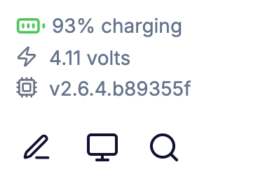

But we’re good now!
The test shows that everything is ok from HW side. (As I expected).

Test firmware shows correct battery voltage (checked with multimeter).
