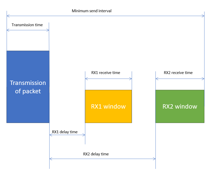

LoRaWAN transmission:
The minimum send interval depends on several factors:
- The LoRaWAN region you setup
- The data rate you setup
- The size of the data you are sending
- Whether you have enabled confirmed packets or not
==> This has an influence on how much time a transmission from the end node to the LoRaWAN server takes.
LoRaWAN regions can have different delays for the RX1 and RX2 windows.
The transmission time depends on your packet size and the selected data rate
If confirmed packet mode is setup, it can be that the TX is only received in RX2 window.
I cannot give you a specific minimum send interval.
Personally I always try to stay above 10 seconds.
But I am sure there are experts here that can give you more details.
