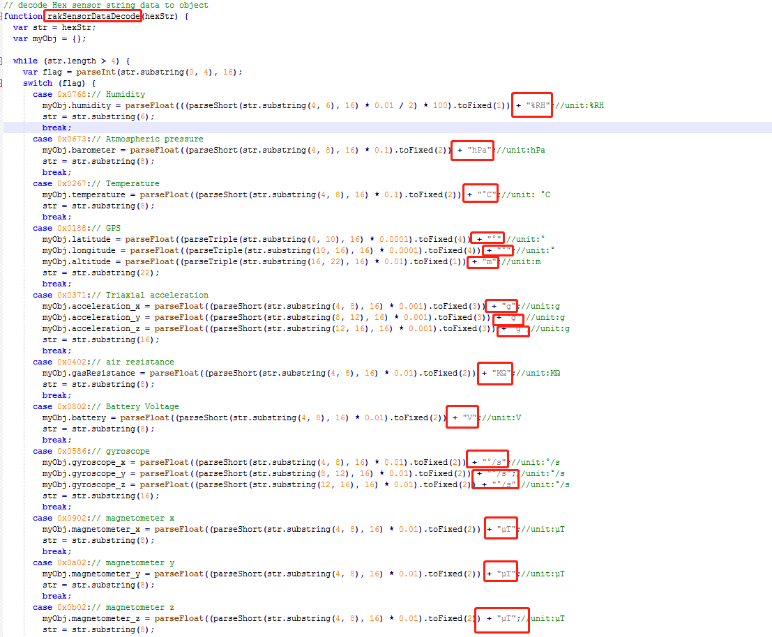

From the device data in Swagger, data are shown in object. This way may not be suitable for you. I think what you need is to list the data separately. I have modified the script, please clone the newest script from github.

The decoded data is with unit. Delelte ā€˜+ ā€œunitā€ā€™ in function rakSensorDataDecode and try again:

Thank you Taylor. Your updated payload decoder will really enhance the Home Assistant integration as Home Assistant likes to define the unit of measurement.
