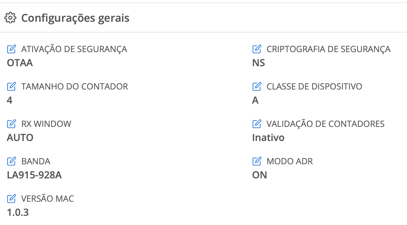

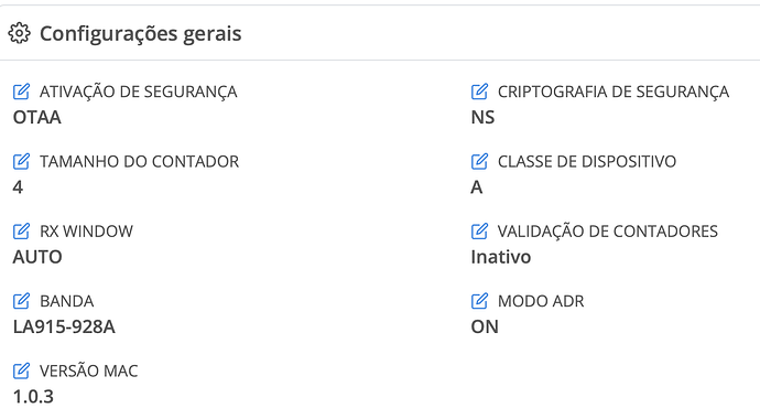

Hi @IGtti,
We’re using the RAK3172 in API mode, not with AT commands.
How did you configure the device on your LoRaWAN server (provider)?
Here we’re still using LoRaMAC 1.0.3 and it’s working fine.
Maybe it’s something related to the network setup.
Thanks,
Diogo
Hi @diogobranquinho
I guess the problem is not related to the network configuration, because in some tests the issue happened even before a connection to the NS.
My configuration is same as your screen:
Activation: OTAA
Cryptography: NS
ADR: ON
Class: A
Maybe this issue is not related to LA915, but with the module operating in AT commands mode! Probably most of the users are in API mode.
