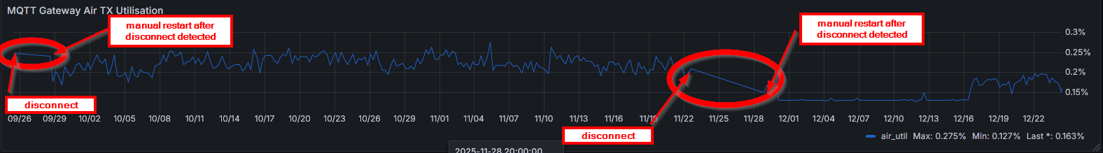

On my side, the MQTT works until I have a connection problem (network provider goes down, brown-out). It seems Meshtastic does not try to reconnect to the network nor the MQTT broker in such a case.
Here is my experience over the last 90 days, two times the Ethernet connection failed, every time I had to manually restart the node to reconnect.
Same setup as you have.

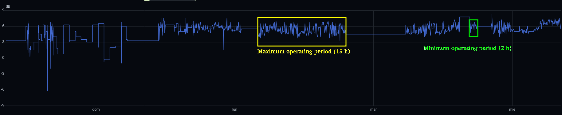

I am seeing something similar on my side, but with much shorter operating periods and occurring on a daily basis. In my case, the node usually stops sending MQTT data after a few hours of continuous operation, instead of after days or weeks.
As highlighted in the image, the maximum continuous operating period I observe is around 15 hours, while in other cases it can be as short as 2 hours before the node stops publishing MQTT messages and requires a manual restart to recover.
This seems consistent with a reconnection or stability issue in the Meshtastic firmware when using Ethernet/MQTT, rather than a configuration-specific problem.
