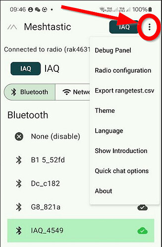

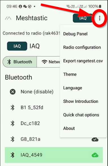

Meshtastic App, click on the three dots in the top right (Android version, no idea how it looks on iPhone)

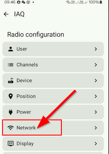

Then select “Network”

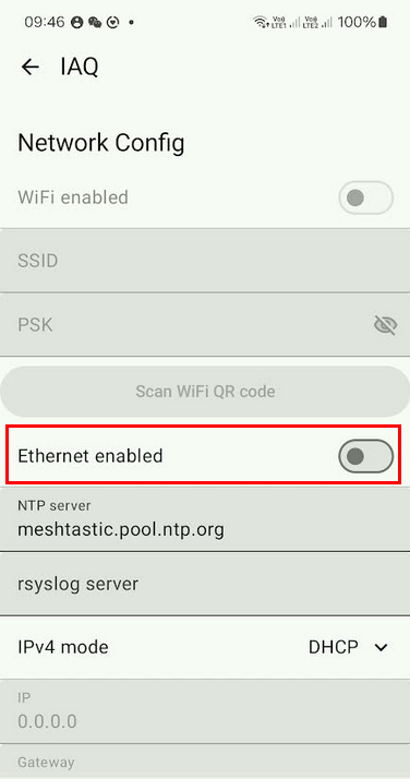

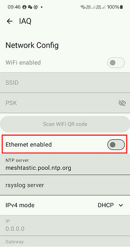

Then enable “Ethernet”
If it’s not there in your mobile app, please contact Meshtastic. We are not developing or maintaining the Meshtastic firmware or their configuration tools.

The screenshot shown above is from a device with a RAk4631 which has neither WiFi nor Ethernet capability, but the app still shows the option .
