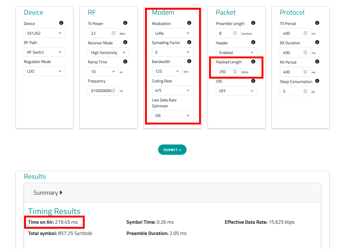

Check Semtech LoRa Calculator to find out how much time a transmission takes.
SF is not the only factor, it depends as well on bandwidth, preamble-lenght, and coding rate.
220ms transmission time with 250 bytes, 125kHz BW, SF 5 and CR 4/5
