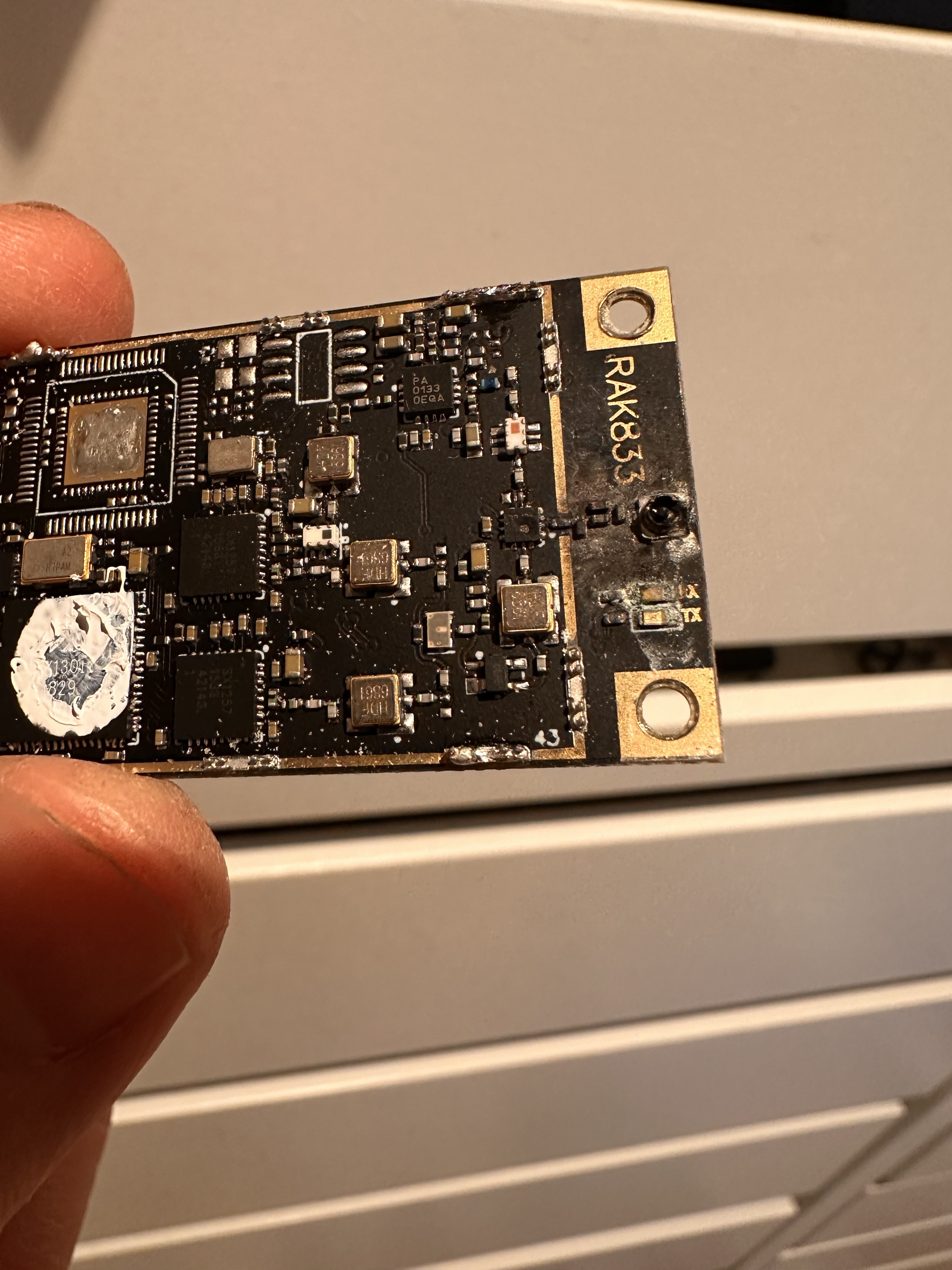

Is it possible to use RAK2287 in a RAK7249 Gateway (RAK4240 V1.0 Board)?
The old RAK833/RAK2247 board has failed, and its not in stock.

Thank you for the reply
The problem with the concentrator is this broken chip.
I cant seem to find out what type of chip this is.
Wort a shot to try replace the chip🤷♂️
Found out what kind of chip, RFSW1012
So, will you be able to recover your concentrator?
Nikola Semov
I’m waiting for parts, I’ll post an update how it goes:+1:![]()
