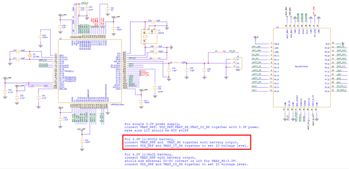

I am using the RAK4630 module and would like to confirm whether it can be powered directly using a 3.6V 19000mAh ER34615H + EPC1520 lithium primary battery pack.
If this is possible, does it mean that no external voltage regulator is required?

That is possible. You need can feed the 3.6V to the supply of nRF52 and SX1262.
There is a note on the schematic.
