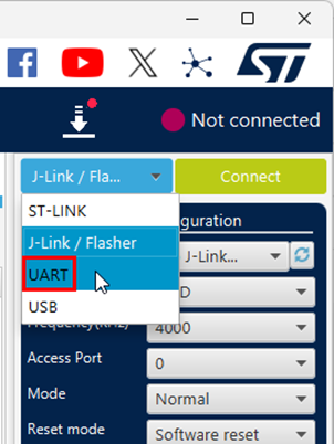

  • Choose UART as connection option

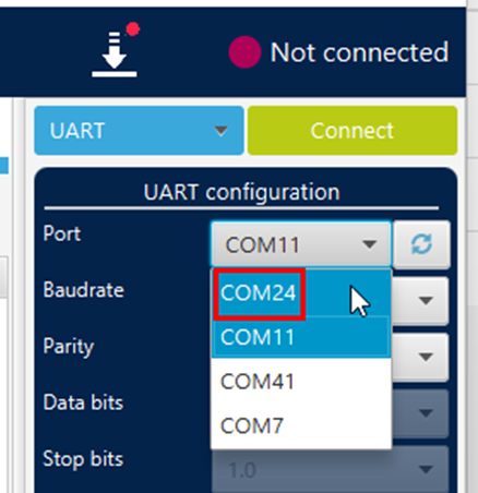

  • Connect to USB of the device (use USB port number, here it is COM24)

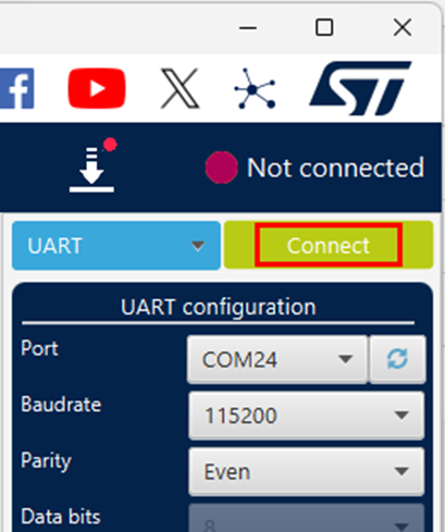

  • Push Connect and check that the device is detected

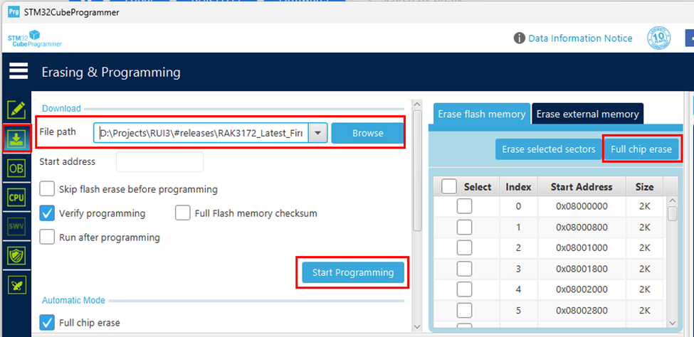

  • Switch to Erasing and Programming in STM32CubeProgrammer
  • Do a Full chip erase
  • Load the file RAK3172-E_latest_final.hex
  • Push Start Programming

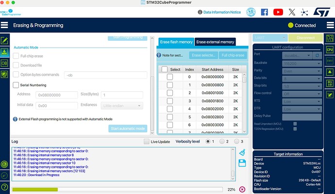

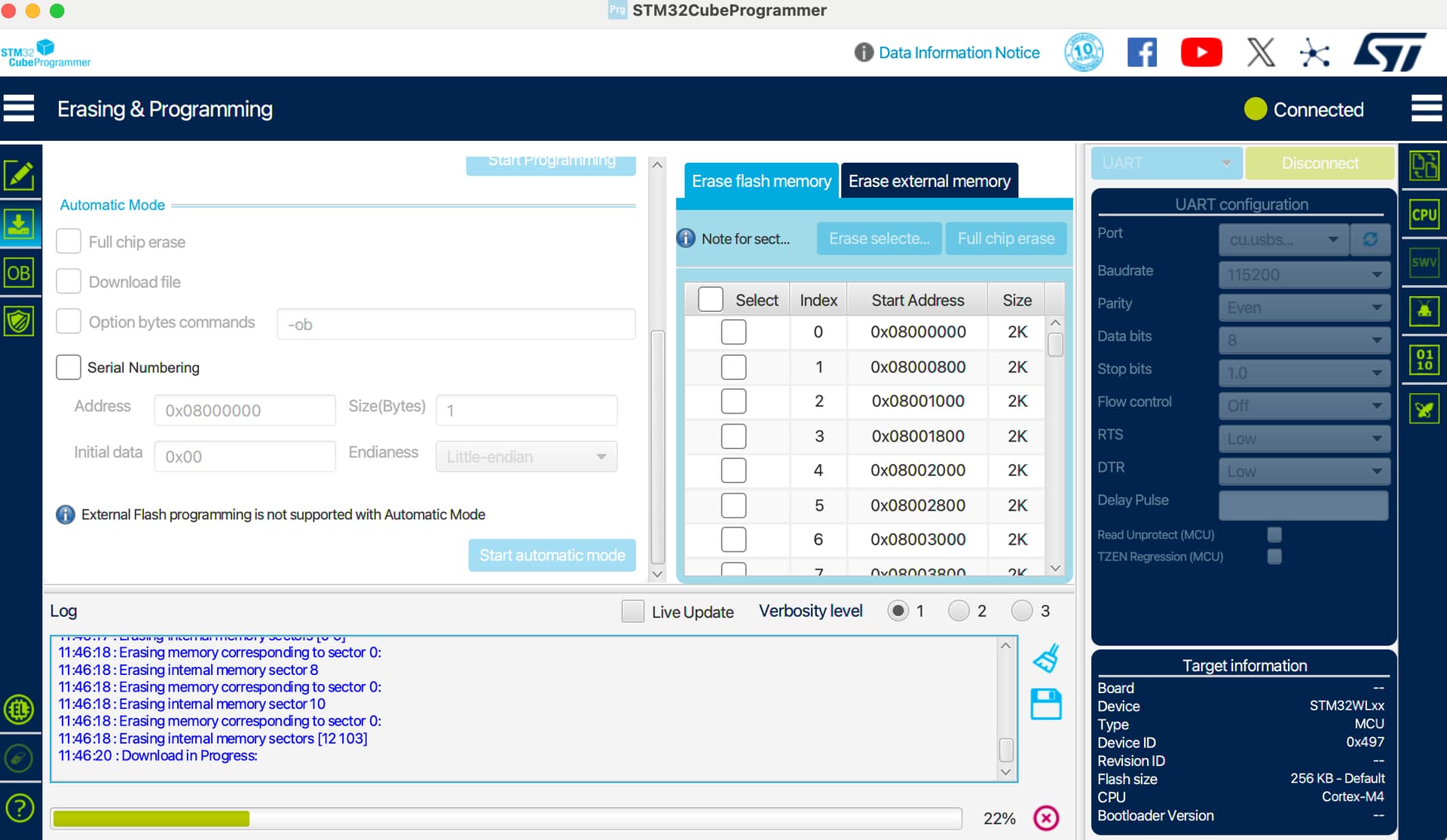

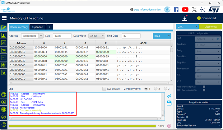

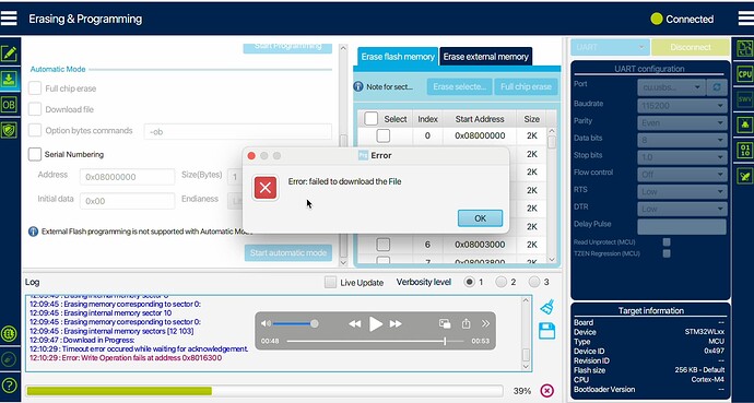

It reaches 22% and then there is a crash…
Try again.
I don’t see a problem in your screenshot, it seems to be still download in progress.
STM32CubeProgrammer works all the time for me.
If it continues to fail, try a different USB cable and a different USB port.

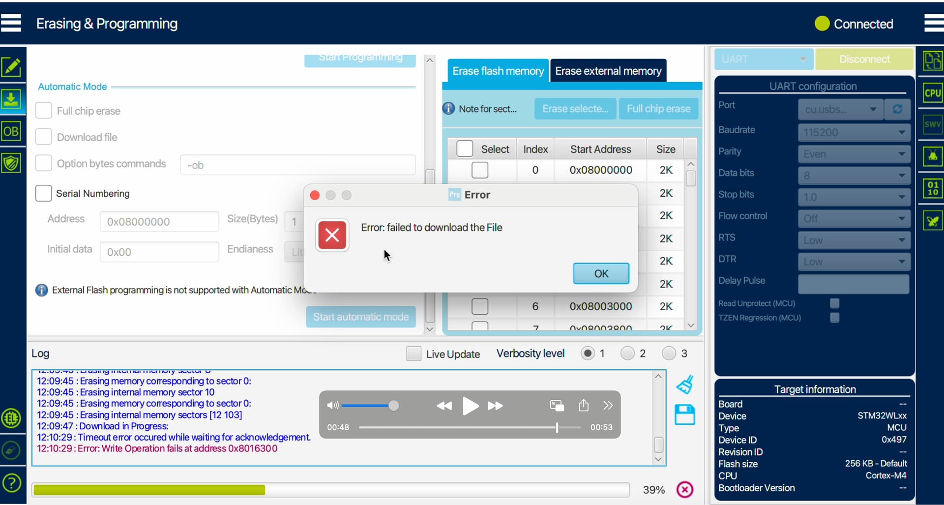

1.Connect
2.Erasing
3.Programing + Error

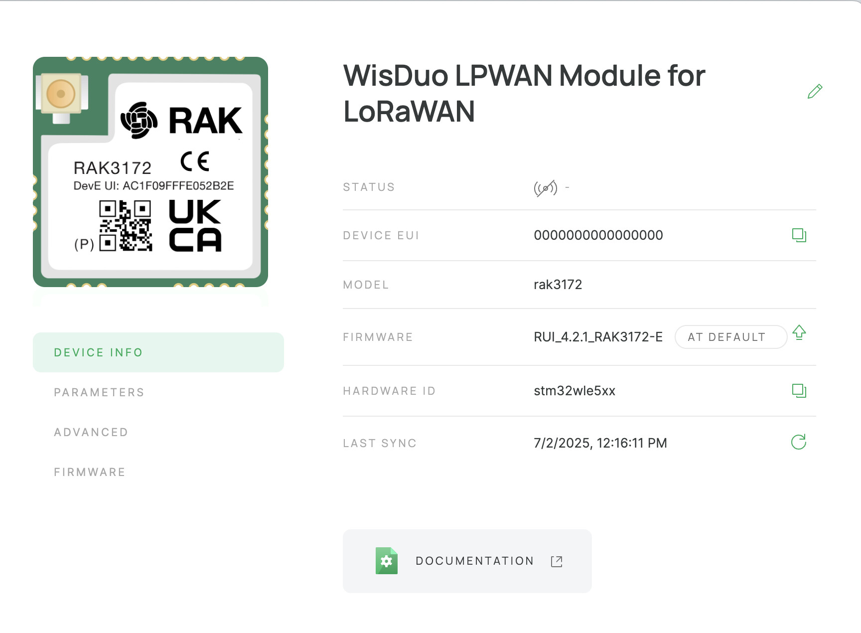

It worked the 4th time, maybe it’s a Mac OS problem - after loading a new firmware, should Device EUI be equal to 0?

DevEUI empty is normal, as you did a chip-erase.
You can set the DevEUI printed on the label and choose a AppEUI and AppKey randomly.

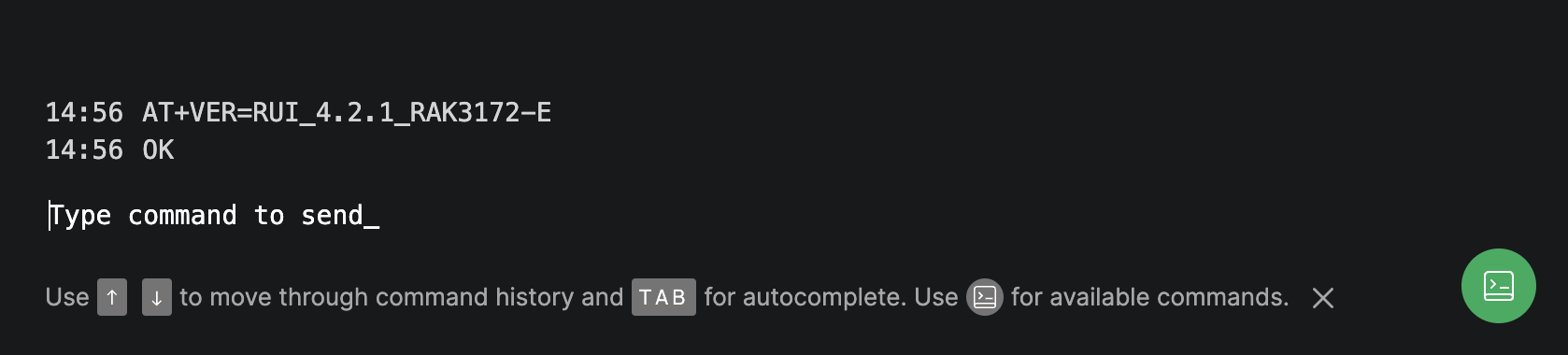

Edit: @beegee It’s actually a strange thing because after issuing the command AT+VER=? the response I get is AT+VER=1.0.0 … Write frimware :slight_smile: again and …

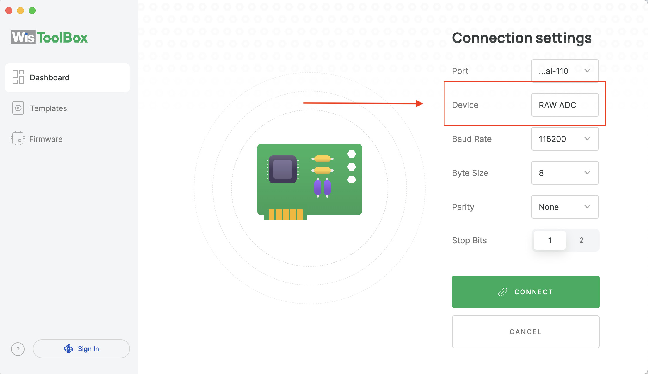

And one more question, what is the purpose of WisToolBox? What is it for in the RAK ecosystem? When you try to connect, see what is in the Device field, the data from my serial port is the voltage from the voltage divider that I send to the serial port… Does this WisToolBox only work for modules in AT mode?
