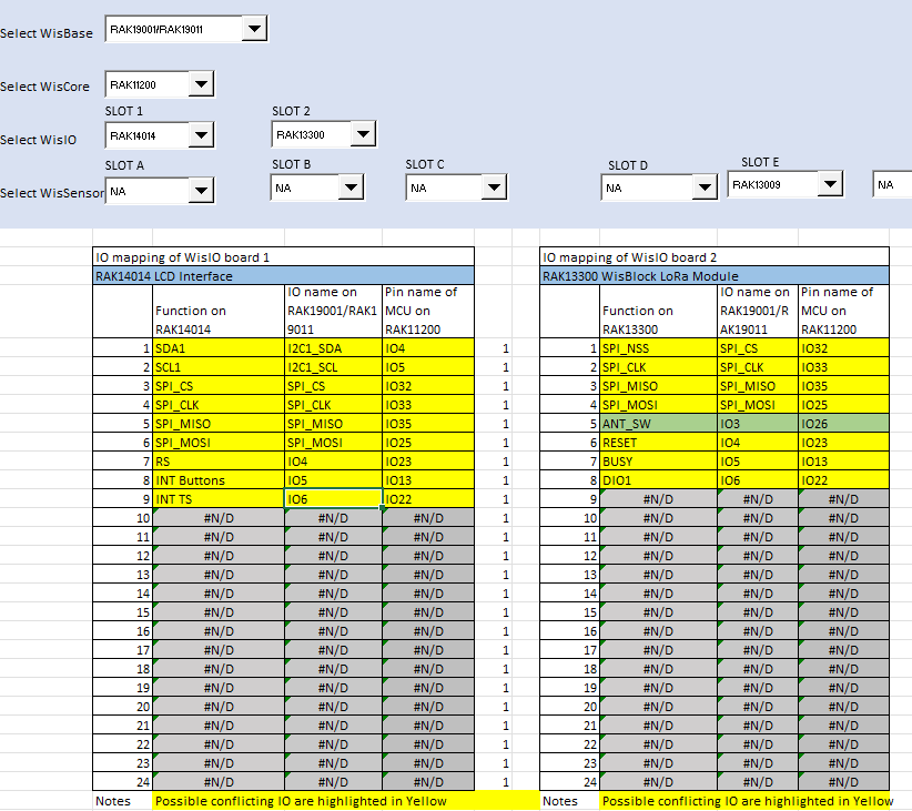

i am trying to integrate a RAK13300 LoRaWAN module with a RAK14014 TFT in a RAK19001 dual base with RAK11200 core. I connected the RAK14014 to IOslotA, and RAK13300 to IOslotB. The problem i am having, is that the touchscreen functionality of the RAK14014 module is not working when both modules are connected, and i think the problem is related to a possible conflict between INT TS pin (RAK14014) and DIO1 (RAK13300), which are both connected to IO22 pin on RAK11200 (WBIO6). Is there a way to solve this problem and use both modules using TouchScreeen functionality?. Any help will be appreciated. Thanks.

Unfortunately there is no solution to use this two IO modules together.
wow, what a drawback. Just an additional question, and sorry in advance in case it is nonsense. Could it be possible to connect the RAK14014 to a wisblock base and the RAK11200 and RAK13300 to another one, and connect both bases using the header signals that could be available on both, in order to integrate all modules to solve this drawback? Thanks for your support.
Not possible either. There is a limited number of IO’s on a Core module and the two IO slots share them.
Adding another Base Board would just share the same IO’s.

Hi, although it is surprising, it has no solution. Best regards.
