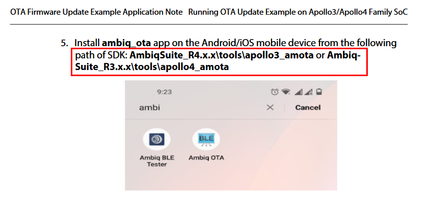

Maybe you can get more info directly from Ambiq, but I found no source for this application.
There are some hints in the AMBIQ SDK documentation page 14
I downloaded the SDK, but there is only the same version that I shared with you already.
