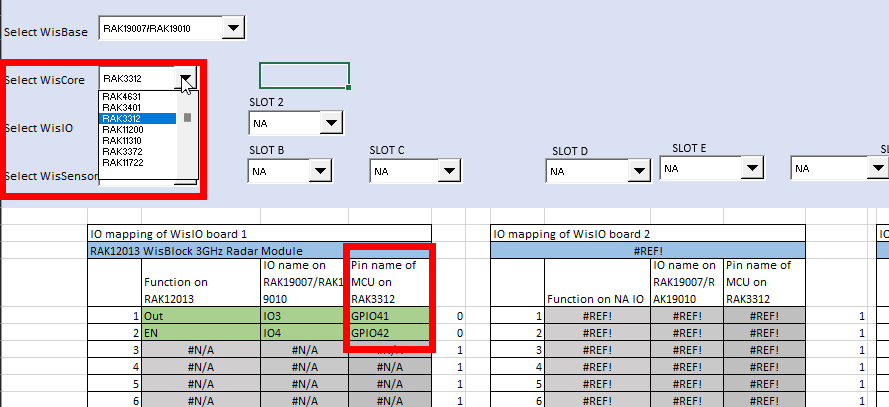

For the GPIO port, it depends what WisBlock Core module you use.
For WisBlock we use WB_IO1 to WB_IO6, but the core modules have different GPIO’s assigned to them.
For the RAK12013 GPIO use
Nordic nRF52840, RAK4631 (RAK4630 on the label) ==> 21
RAP2040, RAK11310 (RAK11300 on the label) ==> 7
ESP32-S3, RAK3312 (RAK3112 on the label) ==> 41
You can always use our Pin Mapper tool to find out the GPIO numbers of a specific MCU:
