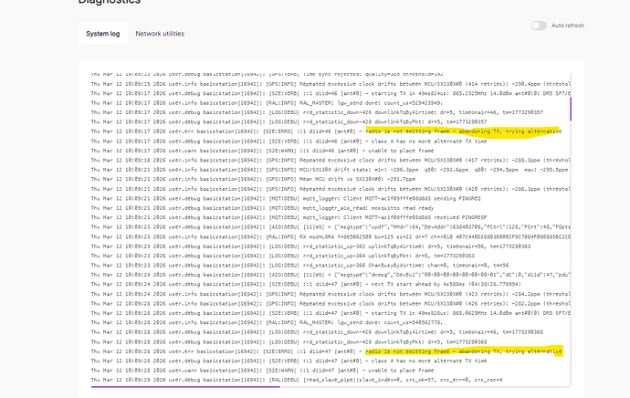

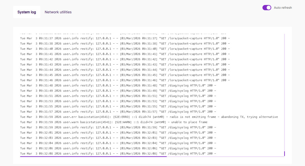

Radio is not emitting frame - abandoning Tx
  • When join fails, am observing " radio is not emitting frame -abandoning Tx, trying alternative" error message in the gateway logs.Gateway logs are added here.
Am using RAKWIRELESS7268V2 Gateway and WisGateOS 2.2.16.
I need support to resolve this

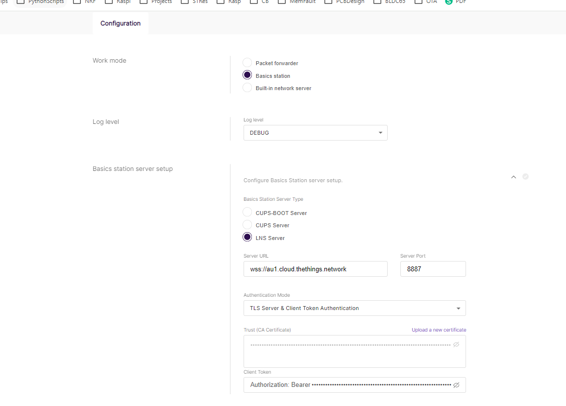

Regarding Gateway
  1. Gate is configured to Things Network
  2. The Gateway Connects to the Home WiFi
    3.Configuration
Logs enabled with Debug
Please note that the issue occurs frequently
Hi @JaeHWan.Jin,
Please find the logs as a text here
