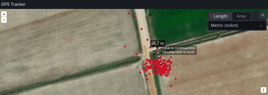

I am using the RAK10700(END OF LIFE : GNSS Tracker for LoRaWAN u-blox ZOE-M8Q)
and the GNSS precision is very low(I have enabled the GNSS with 6 digit).
Was placed to open sky without movement and without big buildings near of it.
The packet interval is every 120sec.
As you could see to the image(is for 12 hours every 120sec gpos) the RAK10700 is on the same position always but every time I get very long positions via the tracker.
Could you help me please???

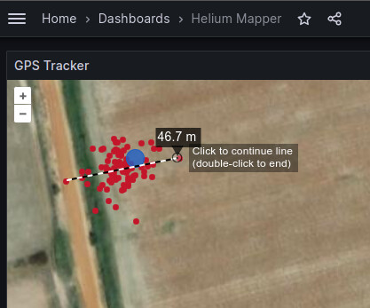

The result of a quick test looks quite good.
This is 1 hour with getting the location every 2 minutes:
Still the same at a sample of 3hours with 2min interval.
