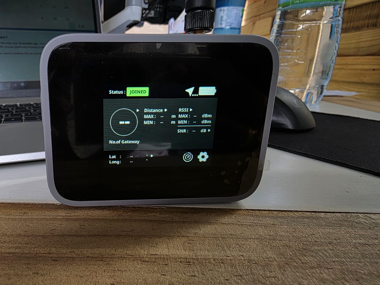

I bought the RAK10710 Field tester and I am trying to receive data. I used the Wistool to update the device and successfully connected to my Chirpstack LNS. I tried all the payloads in the documentation as well as in Github, but haven’t been able to decode the payload.
As I understood, the chirpstack LNS should send a downlink to the field tester so that it can display the number of gateways, distance, RSSI, etc… How can I configure this in Chirpstack v4?
Do I really have to use DataCake?
The field tester displays no information on the gateway, distance and other info.

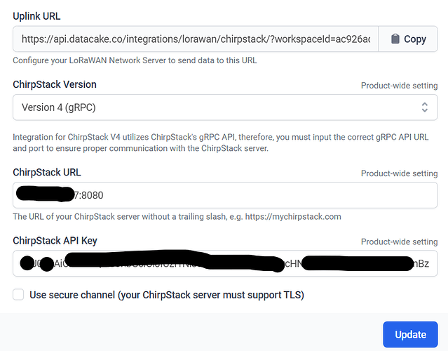

Hello,

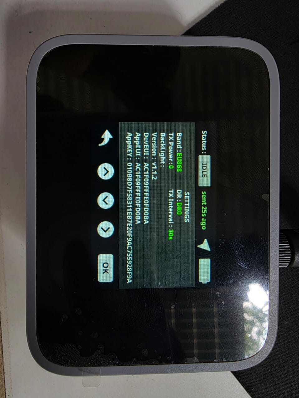

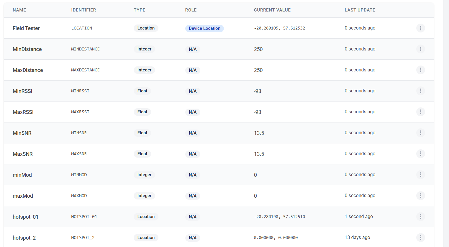

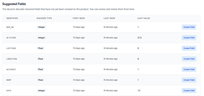

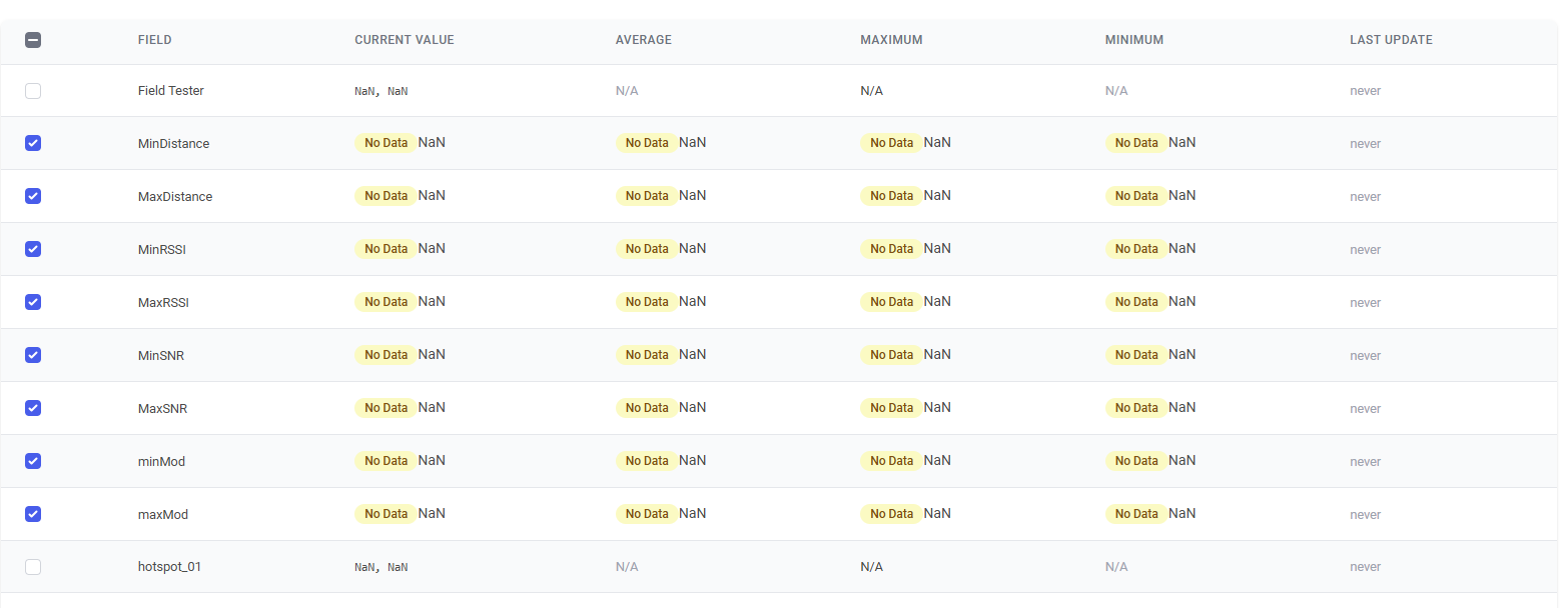

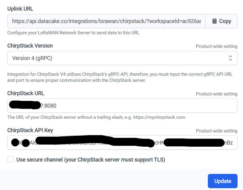

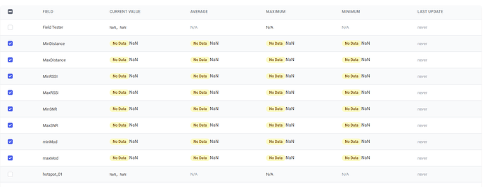

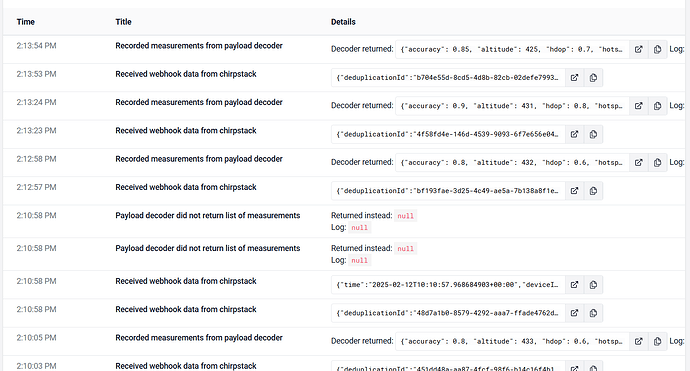

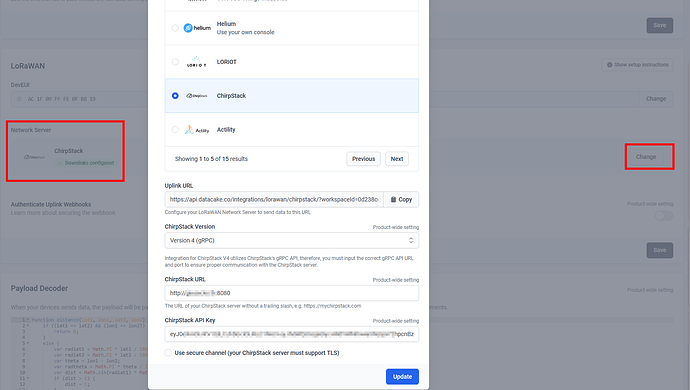

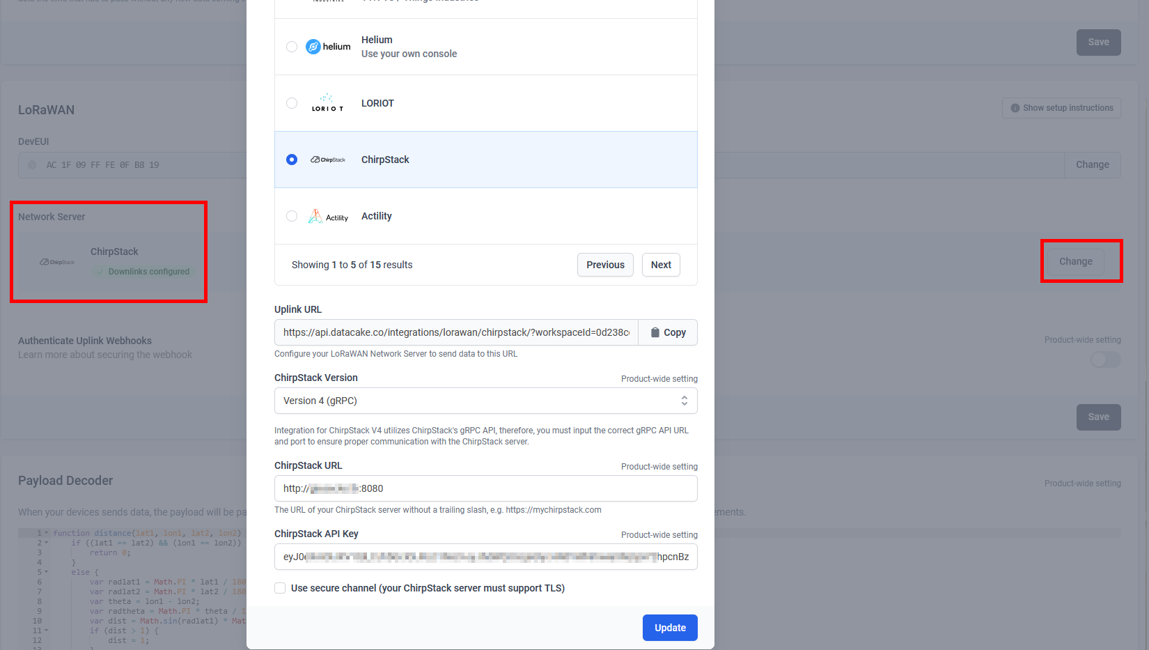

I still haven’t been able to display data on my Field Tester Pro.
I am using chirpstack and datacake.
Please see all details - Steps from tester guide and also copied updated decoders from RakWireless Github.

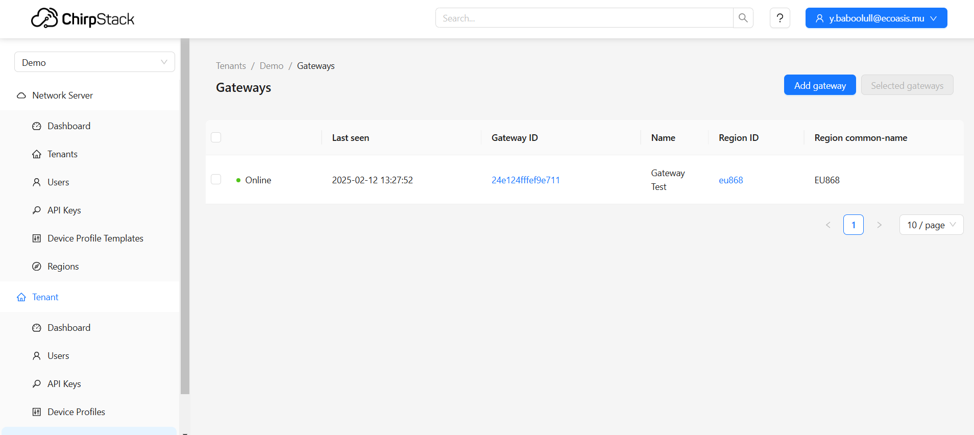

My Gateway on Chirpstack:
Field Tester:

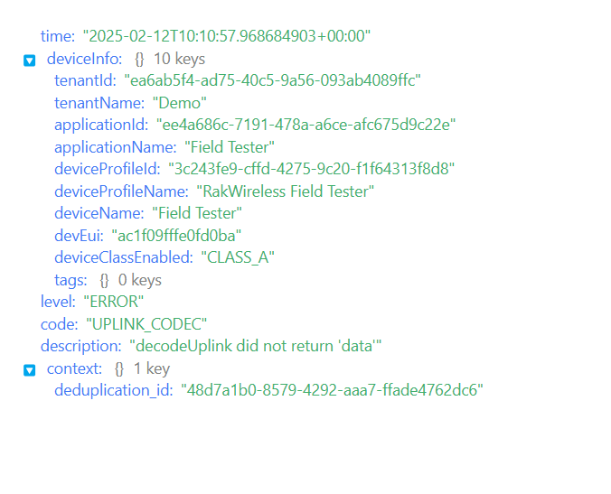

Codec in Chirpstack:
// Decode decodes an array of bytes into an object.
//  - fPort contains the LoRaWAN fPort number
//  - bytes is an array of bytes, e.g. [225, 230, 255, 0]
//  - variables contains the device variables e.g. {"calibration": "3.5"} (both the key / value are of type string)
// The function must return an object, e.g. {"temperature": 22.5}
function Decode(fPort, bytes, variables) {
	var decoded = {};
	// avoid sending Downlink ACK to integration (Cargo)
	if (fPort === 1) {
		var lonSign = (bytes[0] >> 7) & 0x01 ? -1 : 1;
		var latSign = (bytes[0] >> 6) & 0x01 ? -1 : 1;
		var encLat = ((bytes[0] & 0x3f) << 17) +
			(bytes[1] << 9) +
			(bytes[2] << 1) +
			(bytes[3] >> 7);
		var encLon = ((bytes[3] & 0x7f) << 16) +
			(bytes[4] << 8) +
			bytes[5];
		var hdop = bytes[8] / 10;
		var sats = bytes[9];
		var maxHdop = 2;
		var minSats = 5;
		if ((hdop < maxHdop) && (sats >= minSats)) {
			// Send only acceptable quality of position to mappers
			decoded.latitude = latSign * (encLat * 108 + 53) / 10000000;
			decoded.longitude = lonSign * (encLon * 215 + 107) / 10000000;
			decoded.altitude = ((bytes[6] << 8) + bytes[7]) - 1000;
			decoded.accuracy = (hdop * 5 + 5) / 10
			decoded.hdop = hdop;
			decoded.sats = sats;
		} else {
			decoded.error = "Need more GPS precision (hdop must be <" + maxHdop +
				" & sats must be >= " + minSats + ") current hdop: " + hdop + " & sats:" + sats;
		return decoded;
	return null;
// Chirpstack v3 to v4 compatibility wrapper
function decodeUplink(input) {
	return {
		data: Decode(input.fPort, input.bytes, input.variables)

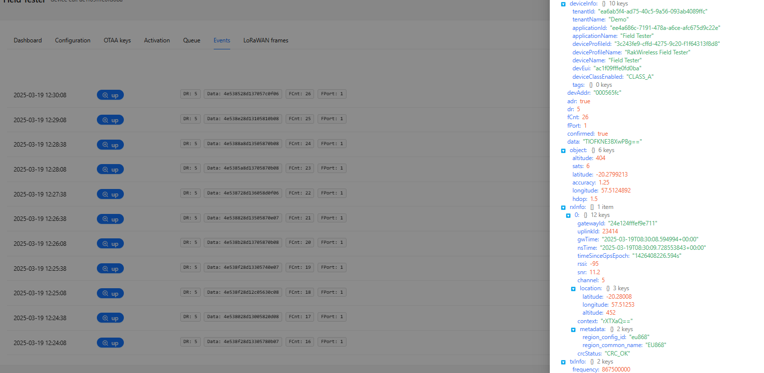

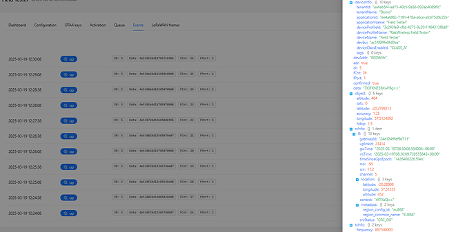

Sample uplink:
        "deduplicationId": "89d1ee68-9353-4e94-b2fe-f5a9a21abbf9",
        "time": "2025-02-12T10:01:33.445+00:00",
        "deviceInfo": {

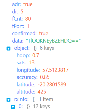

        "object": {
            "longitude": 57.5124892,
            "accuracy": 0.85,
            "altitude": 435,
            "latitude": -20.2800941,
            "sats": 13,
            "hdop": 0.7

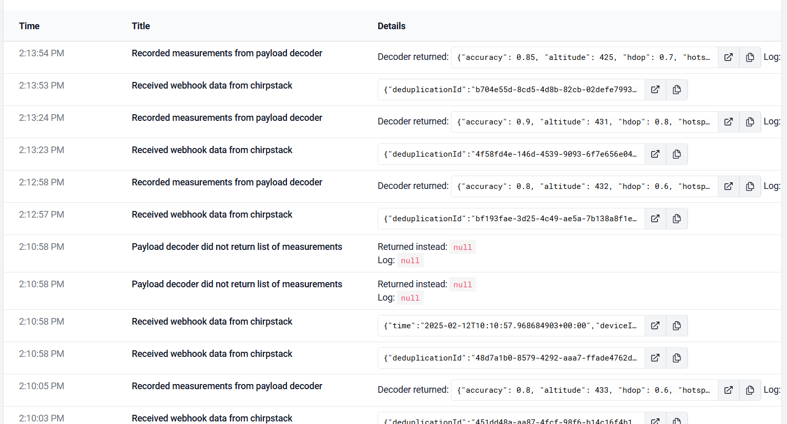

Payload Decoder in DataCake:
function distance(lat1, lon1, lat2, lon2) {
    if ((lat1 == lat2) && (lon1 == lon2)) {
        return 0;
    else {
        var radlat1 = Math.PI * lat1 / 180;
        var radlat2 = Math.PI * lat2 / 180;
        var theta = lon1 - lon2;
        var radtheta = Math.PI * theta / 180;
        var dist = Math.sin(radlat1) * Math.sin(radlat2) + Math.cos(radlat1) * Math.cos(radlat2) * Math.cos(radtheta);
        if (dist > 1) {
            dist = 1;
        dist = Math.acos(dist);
        dist = dist * 180 / Math.PI;
        dist = dist * 60 * 1.1515;
        dist = dist * 1.609344;
        return dist;
function Decoder(bytes, fPort) {
    var decoded = {};
    if (fPort === 1) {
            (bytes[1] << 9) +
            (bytes[2] << 1) +
            (bytes[3] >> 7);
            (bytes[4] << 8) +
            bytes[5];
        var maxHdop = 2;
        var minSats = 5;
            decoded.location = "(" + decoded.latitude + "," + decoded.longitude + ")";
        } else {
        //      decoded.raw = rawPayload.uplink_message.rx_metadata[0].location;
        decoded.num_gw = normalizedPayload.gateways.length;
        decoded.minRSSI = 0;
        decoded.maxRSSI = 0;
        decoded.minSNR = 0;
        decoded.maxSNR = 0;
        decoded.minDistance = 0;
        decoded.maxDistance = 0;
        var server_type = 0;
        // Check if payload comes from TTN
        if (typeof (rawPayload.uplink_message) != "undefined") {
            console.log("Found TTN format");
            server_type = 1;
        // Check if payload comes from Helium
        else if (typeof (rawPayload.hotspots) != "undefined") {
            console.log("Found Helium format");
            server_type = 2;
        // Check if payload comes from Chirpstack
        else if (typeof (rawPayload.rxInfo) != "undefined") {
            console.log("Found Chirpstack format");
            server_type = 3;
            decoded.is_chirpstack = 1;
        else {
            console.log("Unknown raw format");
        var gw_lat = {};
        var gw_long = {};
        decoded.num_gw = 0;
        for (idx_tst = 0; idx_tst < 10; idx_tst++)
            if (typeof (normalizedPayload.gateways[idx_tst]) != "undefined")
                console.log("Found gateway with IDX " + idx_tst);
                decoded.num_gw += 1;
        for (idx = 0; idx < decoded.num_gw; idx++) {
            var new_rssi = (!!normalizedPayload.gateways && !!normalizedPayload.gateways[idx] && normalizedPayload.gateways[idx].rssi) || 0;
            var new_snr = (!!normalizedPayload.gateways && !!normalizedPayload.gateways[idx] && normalizedPayload.gateways[idx].snr) || 0;
            if ((new_rssi < decoded.minRSSI) || (decoded.minRSSI == 0)) {
                decoded.minRSSI = new_rssi;
            if ((new_rssi > decoded.maxRSSI) || (decoded.maxRSSI == 0)) {
                decoded.maxRSSI = new_rssi;
            if ((new_snr < decoded.minSNR) || (decoded.minSNR == 0)) {
                decoded.minSNR = new_snr;
            if ((new_snr > decoded.maxSNR) || (decoded.maxSNR == 0)) {
                decoded.maxSNR = new_snr;
            // var gw_lat = 0.0;
            // var gw_long = 0.0;
            switch (server_type) {
                //TTN
                case 1:
                    gw_lat[idx] = rawPayload.uplink_message.rx_metadata[idx].location.latitude;
                    gw_long[idx] = rawPayload.uplink_message.rx_metadata[idx].location.longitude;
                // Helium
                case 2:
                    gw_lat[idx] = rawPayload.hotspots[idx].lat;
                    gw_long[idx] = rawPayload.hotspots[idx].long;
                // Chirpstack
                case 3:
                    gw_lat[idx] = rawPayload.rxInfo[idx].location.latitude;
                    gw_long[idx] = rawPayload.rxInfo[idx].location.longitude;
                default:
                    console.log("Unknown LNS");
            console.log("IDX " + idx + " lat " + gw_lat[idx] + " long " + gw_long[idx]);
            // decoded.gw_lat[idx] = gw_lat;
            // decoded.gw_long[idx] = gw_long;
            // Calculate distance
            var new_distance = distance(gw_lat[idx], gw_long[idx], decoded.latitude, decoded.longitude);
            if ((new_distance < decoded.minDistance) || (decoded.minDistance == 0)) {
                decoded.minDistance = new_distance * 1000;

DataCake Fields:
Downlink Encoder in Datacake downlink:
function Encoder(measurements, port) {
    var buf = [];
    buf[0] = 1;
    buf[1] = measurements.MINRSSI.value + 200;
    buf[2] = measurements.MAXRSSI.value + 200;
    // var temp = parseInt(measurements.MINMOD.value,10);
    if (measurements.MINMOD.value == 0) {
        measurements.MINMOD.value = 1;
    console.log(measurements.MINMOD.value);
    buf[3] = measurements.MINMOD.value;
    if (measurements.MAXMOD.value == 0) {
        measurements.MAXMOD.value = 1;
    buf[4] = measurements.MAXMOD.value;
    buf[5] = measurements.NUM_GW.value;
    return buf;
Debug Log in DataCake:
Sometimes, I receive this error in chirpstack:
The only data I can see on Chirpstack are:
Kindly advise if I am doing something wrong.
From your logs, it seems that Datacake is able to decode the payload.
Did you configure “Downlinks” in the device configuration in Datacake?
In the “Downlinks” configuration, make sure you selected Chirpstack Version 4(gRPC)

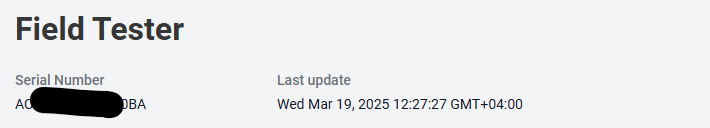

Hello,
Here is the downlink configuration in Datacake:
Datacake last update:
Datacake History Blank:
Data in Chirpstack:
