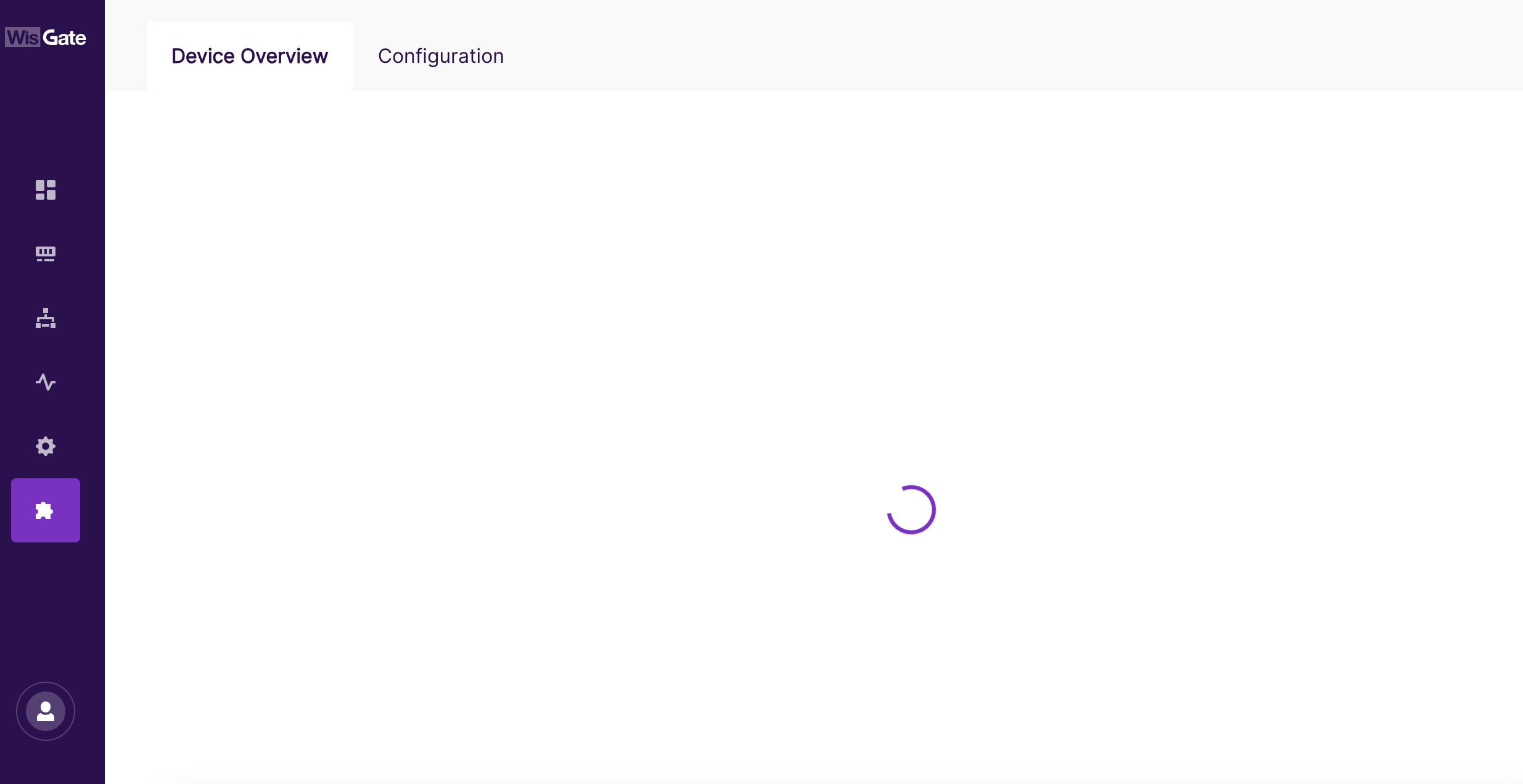

After these corrections, I got no luck getting a downstream message to update the info in my field tester. Also, my field tester extension doesn’t show anything:
Any pointers on how to solve this issue?
