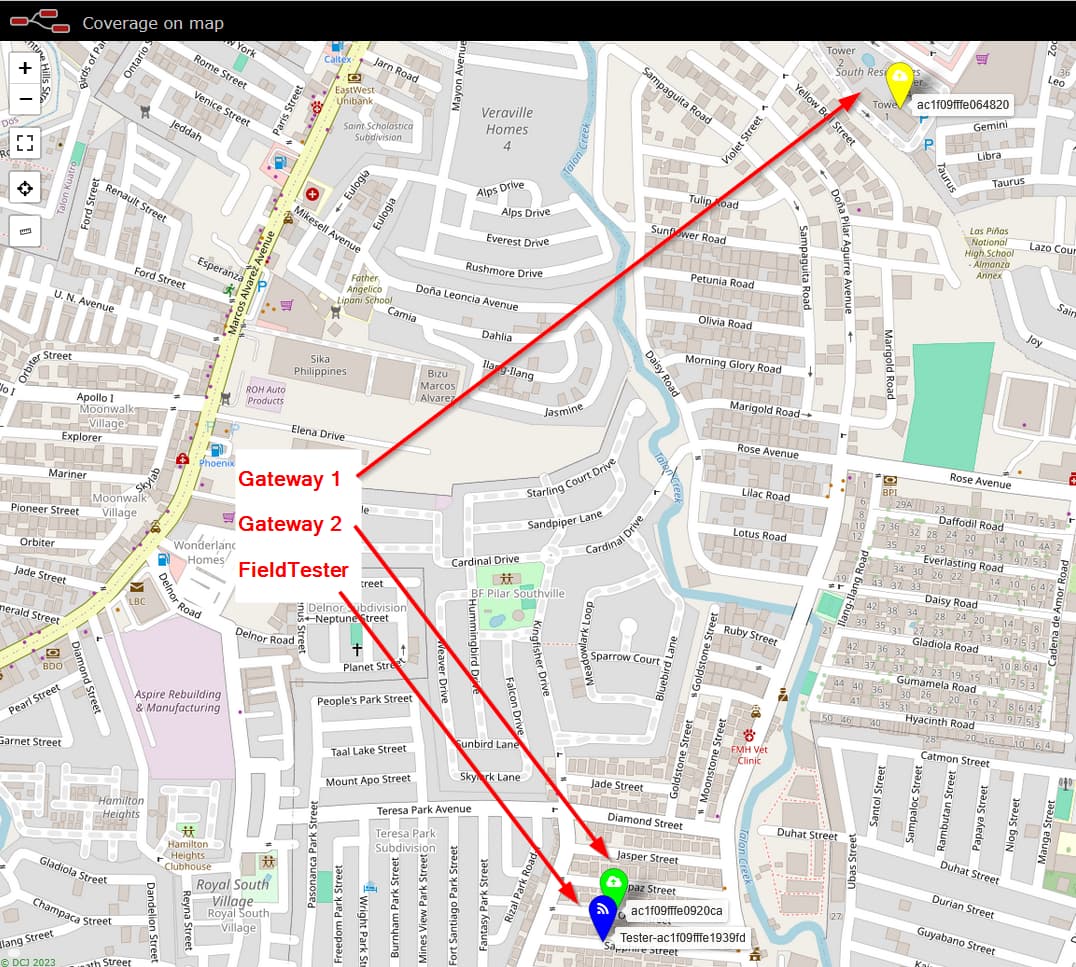

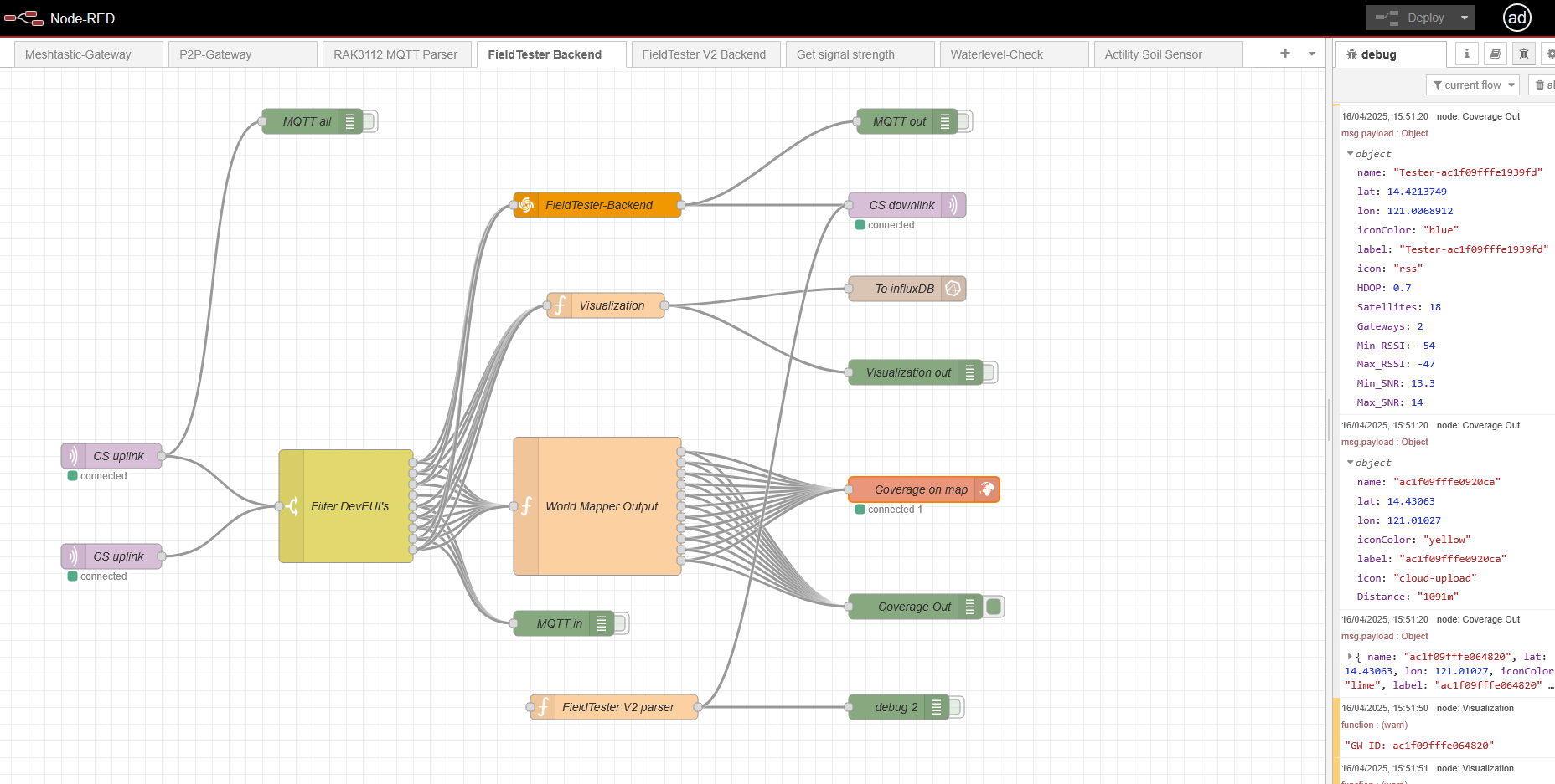

You want something like this?
I made it with NodeRED and it is running on my VPS.
Did not share it, it was just for my personal usage.
Works with Chirpstack V4. Will need some changes to work with TTN.
Has some additional info on the map as well:
Thanks a lot @beegee for the share :wink: I’ll investigate how to do it in my NodeRed in Home-Assistant and display datas directly in HA !
I can share my NodeRed setup if it helps.
Thanks for the offer and yep would be fantastic @beegee :+1:
No problem to share it, but I think I have to add a bunch of comments to it.
I will create a document with explanations for it.
